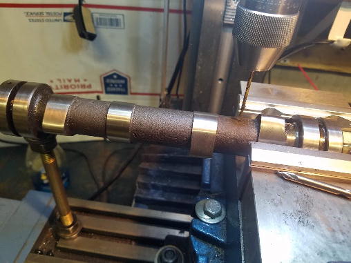

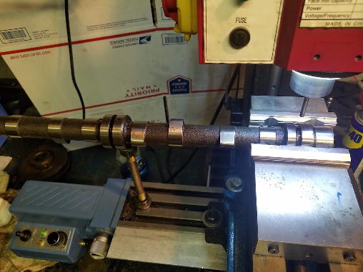

Now comes the fun part. Before I reinstalled the cam, I noticed that there were no squirt holes in the camshaft for oiling connecting rods. So, I took some measurements and drilled the holes, cleaned, and oiled it again, and reinstalled.

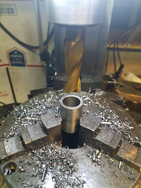

After measuring the bore and the depth for the thrust plunger at the end of the cam shaft. I should be able to make a steel sleeve and press it into the hole. The hole is deeper than the one from the "B" so I can put a flat in the bottom to catch the spring. I am looking at a sleeve 7/8 OD, 5/8 ID. 1 3/8 deep.

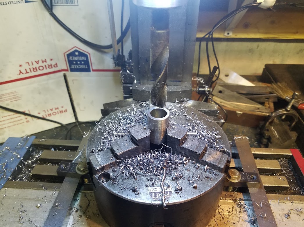

I spent some time while recovering from surgery, reworking the camshaft for my A/C B. I want to send my sincerest thanks to PaulB for his advice.
I placed a piece of 7/8 diameter round stock into my 3 jaw chuck. I brought into height so it is flush with the end of the camshaft. I drilled it out and placed a flat counter bore at the bottom of the hole for a place for the spring to rest. I have no idea what the original length of the thrust plunger was, so I set the plunger at the same height as the one from the old cam.
