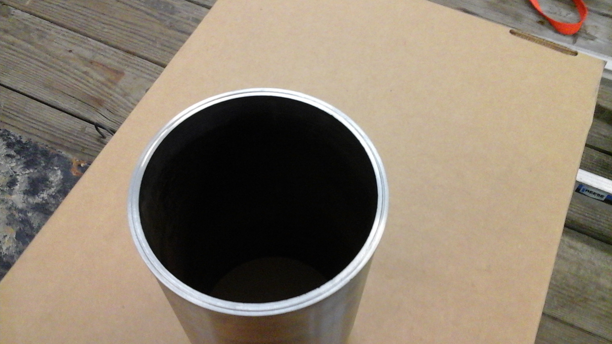

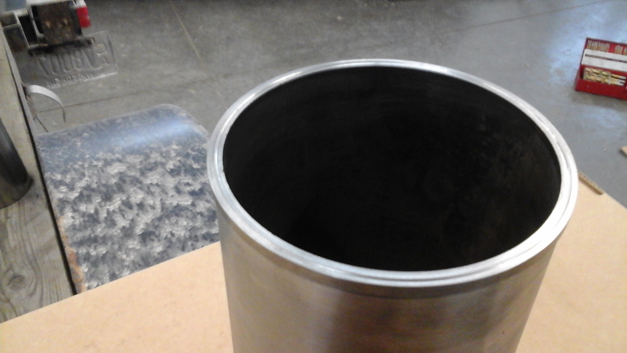

Defiantlyput o ring on sleave, I make my sleaves with o-ring.
Posted By: Robacpuller
Date Posted: 05 Feb 2022 at 7:40pm
I TURN o ring right on top. .015
