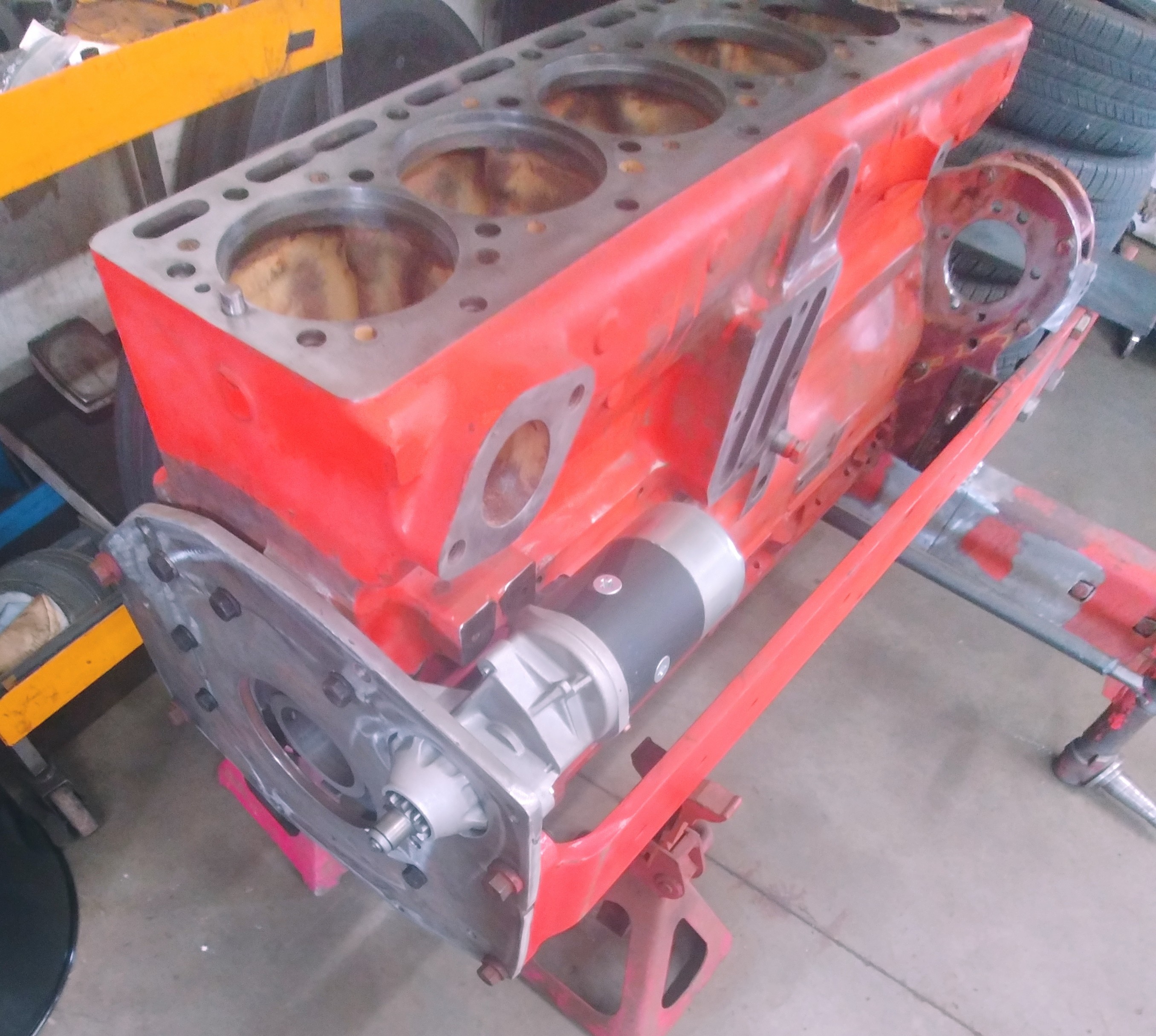

I used the 426 plate from a 7580 and relocated starter to 301 position. Grind some off the block(3500) to make starter fit. Relocate oil filters and custom flywheel to use 301 ring gear.

Gottcha, thanks- was thinking about using the 426 engine plate redrilling holes for the 200- and using a 301 flywheel and clutch - sounds easy !!!

Date Posted: 26 Dec 2021 at 9:21pm

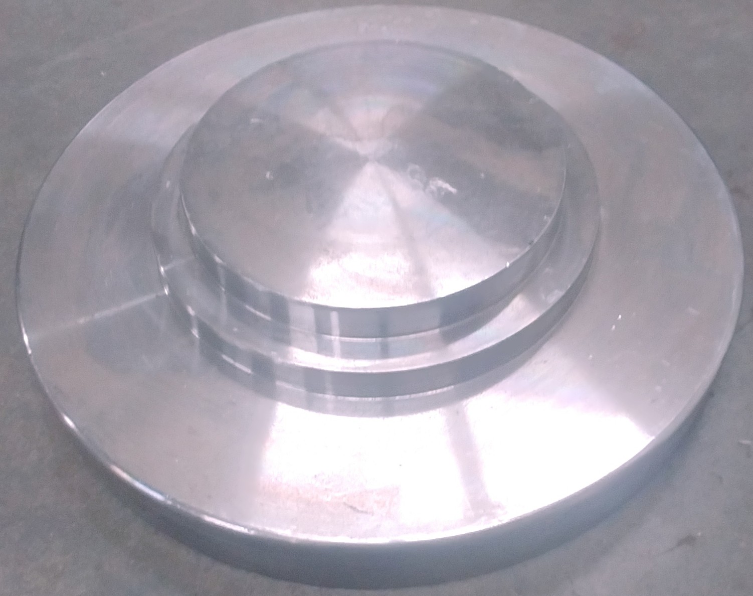

My centering device to lay both back plates on

Dang Goomer you got it going on there ! Nice
