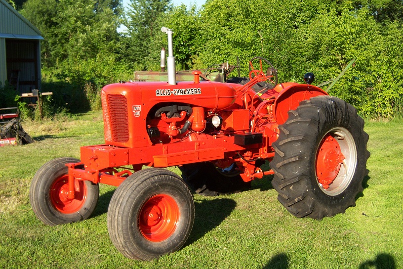

Posted By: Allis dave
Date Posted: 15 Sep 2021 at 9:29am
I have 16.9 28's on my WD45 no problems and I can spin them all the way in, BUT an owner before me and before the bigger welded about a 3/8" spacer on the inside of the fender mounts and mounted the fenders inside the brackets instead of outside. Works well and no one notices.
Date Posted: 15 Sep 2021 at 9:30am
16.9 pics

Posted By: TomYaz
Date Posted: 16 Sep 2021 at 6:51am
Originally posted by Allis dave Allis dave wrote:
16.9 pics
that dont look to shabby...so my 16.9s on 15" should work...was there any mods done to make it so ? (not talking about those duallys...)...Lonn mentions some fender supports?
