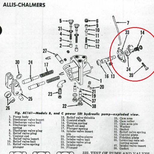

also inspect the valve from the outside. There are two  round plates  ( about 3 inches diameter) laying on top of each other. One is attached to the hydraulic lever, the other is attached to the valve shaft.. Spring between them... look it over and make sure nothing is BENT or BINDING and the plate is attached to the valve rod. ... maybe spray the assembly with CRUD CLEANER if it is covered with crap.

Posted By: steve(ill)
Date Posted: 11 May 2021 at 9:11pm
John, you realize the system is POWER to lift and the arms FLOAT down and push the oil back out of the cylinders ?  If you have no WEIGHT on the arms, then will not go down.. You need a blade, bucket, weight, something on the arm to push it down.... You can actually stand on the arm and  pull the hyd lever up and it will raise you and the arm.  Let the lever go to mid range and it will HOLD... PUSH the lever forward and your weight should make the arm drop.
