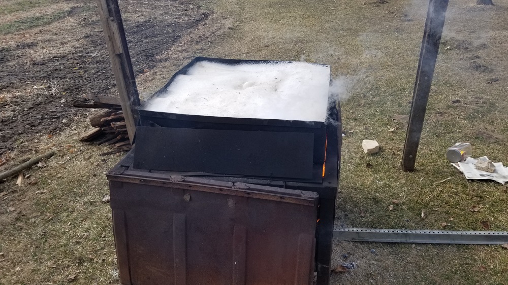

Posted By: Sugarmaker
Date Posted: 01 Mar 2021 at 7:20am
Folks,
Here a couple pictures inside the arch. (The structure that supports the pans).
This set of pans and arch are designed for a type of pan called a drop flue. The flues are approx 3/4 inch wide, 9 inches deep and 5 foot long. There are 14 flues. the heat/ fife has to pass through these to get up the chimney. They provide more surface area to the pan and therefor additional boiling efficiency.
Sorry I did not have the ashes cleaned out well when I took this:
The fire is held up on a set of steel grates. I have added a insulated door to this old arch. It also has a air blower under the grates and a air delivery system along the upper edge of the firebox to burn the gasses. Typically refer to as AUF (air under fire) and AOF (Air over fire) systems. Again further features added to improve boiling rate (gallons of sap per hour). (You can see the AOF nozzles protruding through the firebrick in the first picture)

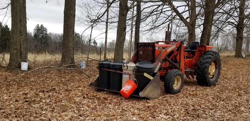

Some pictures from yesterday:
Collected 325 gallons from my trees, 60 gallons form another neighbor, 25 gallons form another neighbor, and 6 gallons for Rhett and Coopers sugarbush in the yard. Tank has about 160 gal in it here.
Just another day in the roadside sugarbush. Here is a drop line about 30 inches long, 5/16 I.D. plastic tubing.
This is the spout or spile. A 5/16 dia hole is drilled about 1-3/4 deep, then the spout is set gently with a hammer so not to split the tree. The tubing is forced over the barbs on the black spout, using a special tool.
Red tape on the hose is where I had to do a road side repair of a broken wire, in my remote pump switch.
The remote pump is a 2000 GPH RULE pump. Both pumps been great and bullet proof                                                                                                                                                                                                        !

Old school Leader 3 x 8 no hoods, feel the steam!
Now that there is a boil!:

Chris, We lit the fire at 8:10 and had our first draw at 11:50. Being the first day, we started with nothing but sap. Tomorrow, we have "sweet" in the pans and will probably get the first draw by 9:00. We made 11 gallons today.
I use a hydrometer to determine when to draw. Tehn I follow the temp on the dial thermometer to decide when to shut the valve. My 3X10 is also a King style, made by Leader in 1997. Stainless steel soldered pans using lead free solder. I took the syrup pan back to Leader in 2019 to have some repairs made to the pan. They are very good to work with. Bob@allisdowneast
I used to think I was indecisive, but now I'm not sure.

Back on the road to gather 400 gallons of sap with Neighbor Keith T who just decided to hang up the scoop. Keith will be 90 this August and felt he should stop making syrup on a high point. He had made 30 gallons of Amber and Dark this spring.
My roadside sugarbush (Fullers) about a mile from the house.
