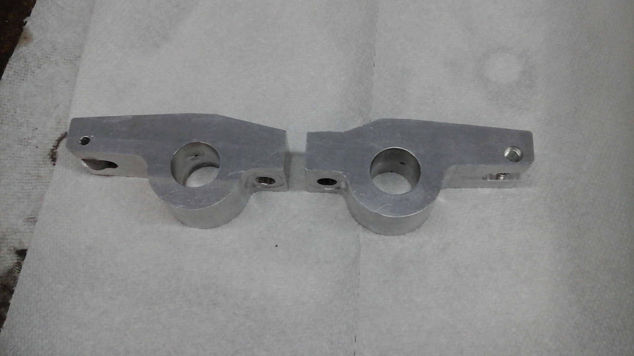

New design, and price.
1.70 ratio
$300 per set, price includes new nuts for adjuster and shipping.
Rob
608-228-4843
New design on left, old on right

Is stock ratio 1.5?
Posted By: Robacpuller
Date Posted: 23 Dec 2020 at 10:35pm
I think they r around 1.46. These r 1.70 and u just replace old ones, use ur old stands and springs, adjusters. Simple

Any issues with valvetrain clearances

No, I just 45 degree number 1 exhaust valve and number 4 exhaust valve for head bolt clearence on tall head. Don't have to clearence on short head. Put on,adjust and go. I need to know if u have a tall or short if u want a set.
Date Posted: 28 Dec 2020 at 8:51pm
I clearence rocker for head bolt, not valve. I did not explain that very good.
