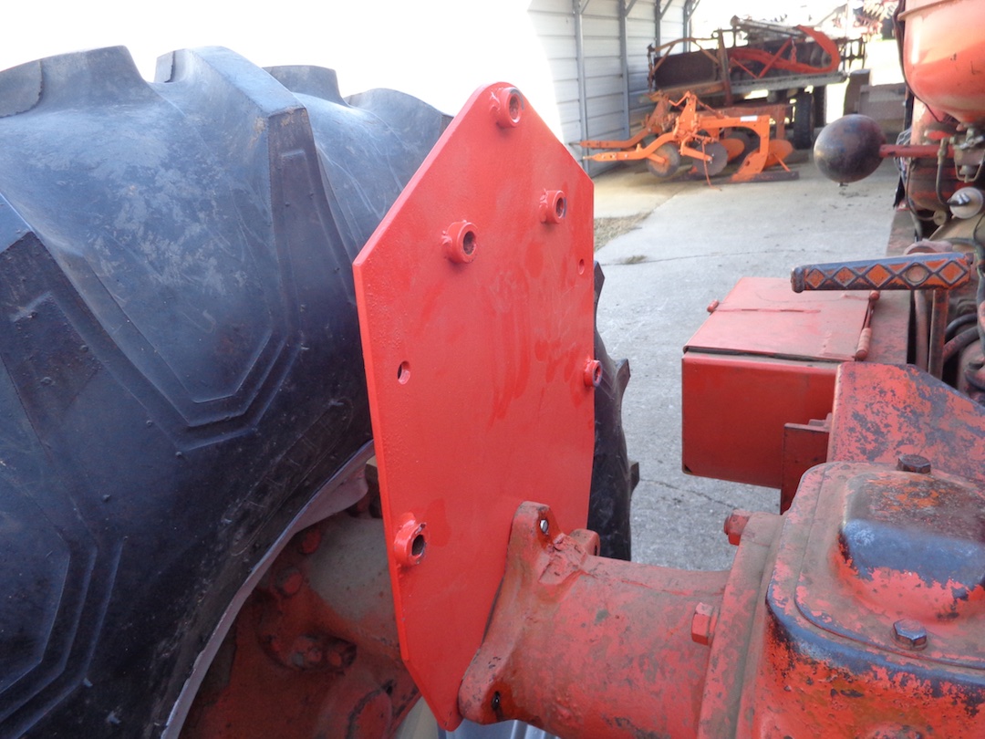

Anyone ever seen mounting brackets like this? Thought they were home-made at first but I'm not sure of that. They let you mount the fender on the inside. I had put them on WD 'Micha' thinking the extra clearance would be good there. Turned out the 45 needed them more, the 16.9's would rub and I didn't want to move the tires out. Switched them yesterday, now everything fits good.

Not factory, but look nicely made.  Someone who works at a fab shop might have made it  - too nice for a backyard farmer creation.

I have a couple sets and have seen them on other tractors. They were the tall ones for the later WD45 tractors.

Kind of what I thought too. They are pretty well made.
Lon, yes, tall brackets.

You can also move the brackets to the inside of the cast with a little work.....
