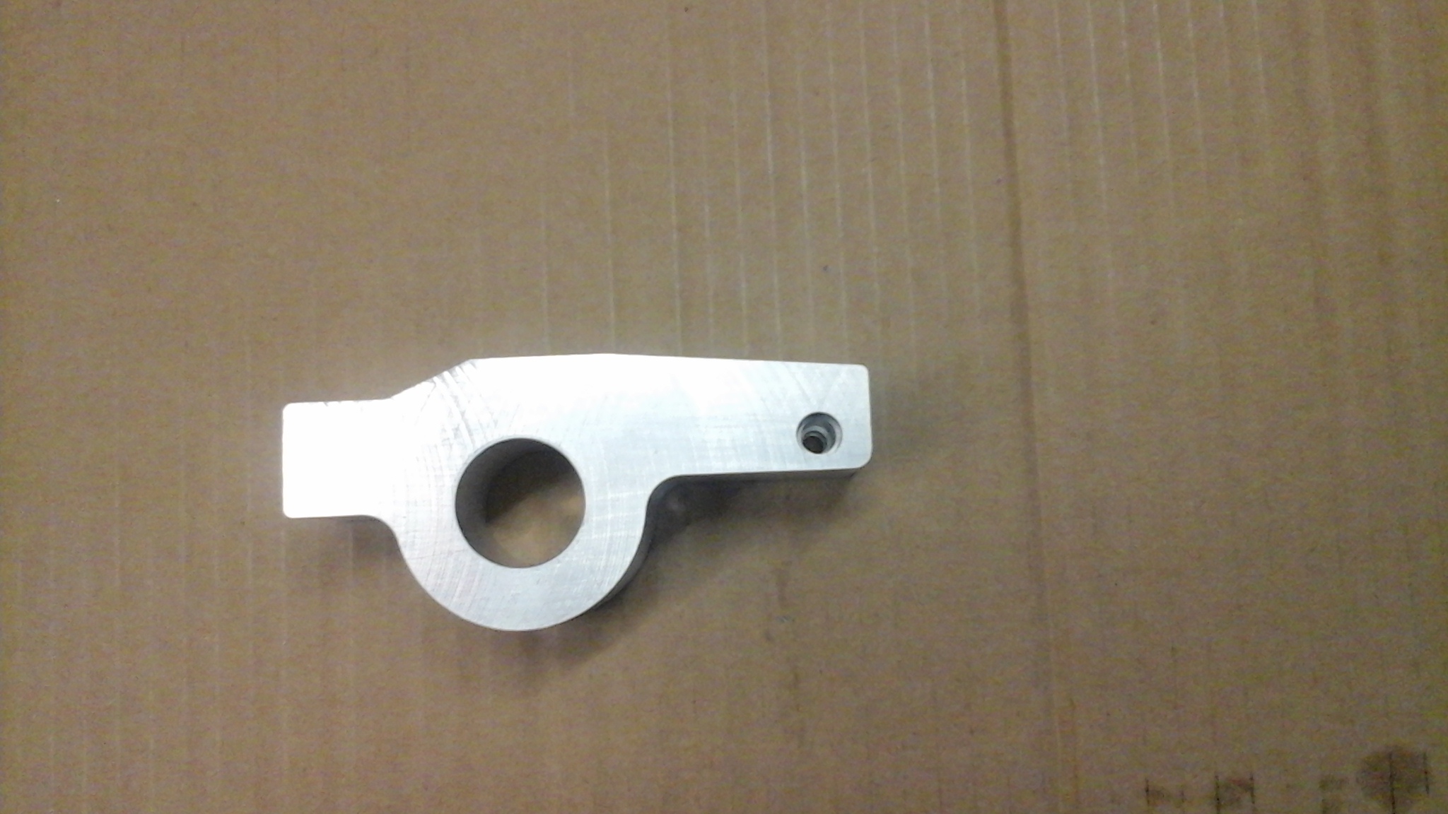

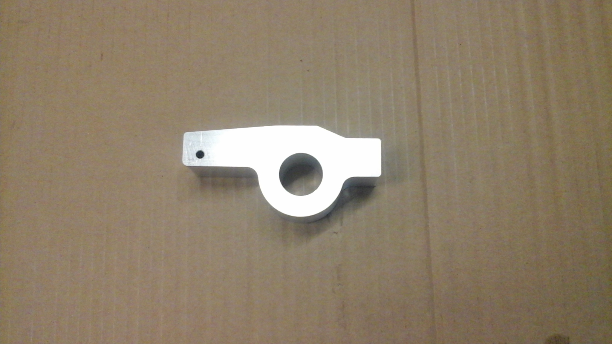

I make 1.70 roller tip rockers that can give u a little more .
$275 a set.
Rob

They will work on stock valves or others. Mine has big block chevy valves.u will have to tell if u r using a short or tall head. I use a short head, if tall I have to clearence #4 and #1 exhaust for the head bolt. Make sure u degree the cam, and the cam person should tell u how many degrees off cam center line. Mine is a 4 master grind 106 -107 off cam center line. I had to advance cam 1 tooth plus we made a halve key.just advancing the cam 1 tooth will help. If u put a dial indicator on a stock set up , u will see that the piston is coming up on compression stoke before the intake valve is closed. U will want it closed at bottom dead center. To use my rockers all u have to do is replace them with old ones, use ur same spring and adjusters. I made them a simple replacement.
Let me know if interested.
Thanks
Rob
