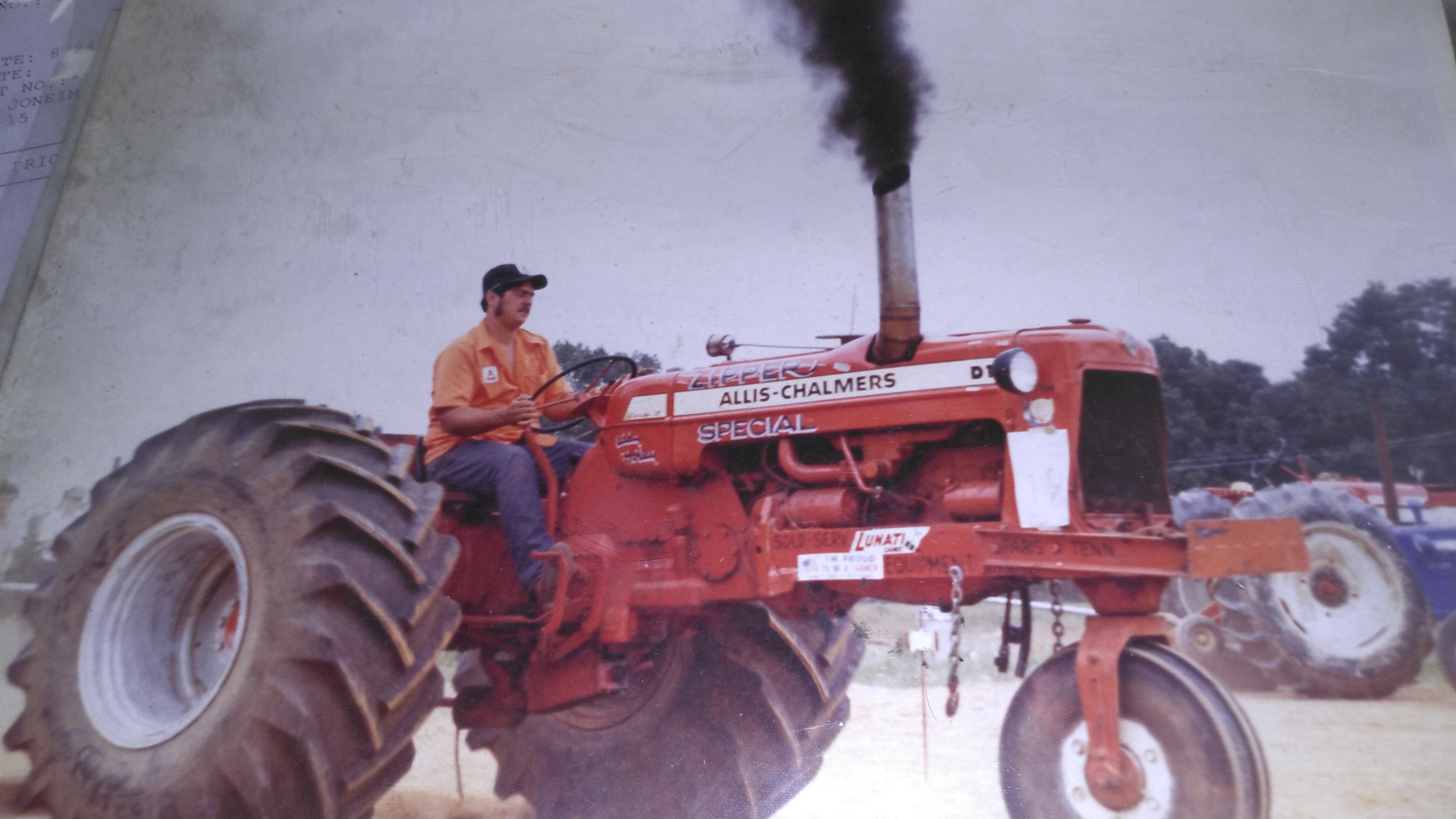

Circa 1972.........  D262 copper head gasket  - oring 'd sleeves   35 mm 4 roller pump
Switzer then staged  turbos -  lots of smoke  7th gear in 5000# 6th gear in 7000
HP ? maybe 200 ? 250 ?  Never burnt piston - indirect injection.   More fuel never increased hp  when we went from 4 roller 31 mm  (220 Pump size)  ...  Zipper Special was named so with reason....  Oh, and used D19  PD clutch to start...  in 5 years replaced final drive, trans, torque hsg gears, crank cam... and on and on  but it was fun...

Now we're talkin !!!   Look at the lug depth on those tires !!!   That is one of the reasons todays pullers don't have much (if any) rear end issues. The sleds start easier and the tires have a much shorter lug so you can spin them faster, making the driveline last longer. I like the " more fuel never increased the HP" line...………   They say todays very best Super Stock 3 or 4 turbo diesels make between 3500 and 4000 HP at 270 to 300 psi of boost.
