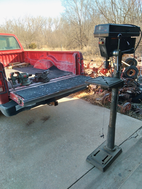

It took a long time but I finally brought one home today. I've been keeping an eye online for used ones, and checked pawn shops now and then. The ones on CL/FB either disappear quickly if priced reasonably, or people are asking the same price as new for 10 year old Harbor Freight ones and they never sell. The pawn shops around here were very high, too - maybe $50 or $100 less than new on the HF or Craftsman models.
This Craftsman 15"/1 HP popped up today for $125 with the cross slide vise (probably HF). The quill seems to be nice and tight but the chuckcould probably use upgrading. The guy threw in the the other vise for $20. It has Chinese lettering printed on the tag but what the heck... Figure I can get that much use out of it, at least.
Thanks to everyone here for your input and suggestions. I'm hoping this will last me for decades for the occasional jobs where I need a drill press.
Posted By: plummerscarin
Date Posted: 12 Feb 2022 at 8:44pm
Looks like a nice. Wish the table was that big on mine.

Posted By: steve(ill)
Date Posted: 12 Feb 2022 at 9:00pm
My 1980 model looks just like that... Does it have the real small 1/4 inch belt ?  I thought that would never last... I bought one after 5 years and kept as a spare.. Finally installed it when the original was 25 years old... New one has 15 years on it and NO PROBLEMS.. suprised me ?  I set on the slowest speed and never move it.
Posted By: wjohn
Date Posted: 12 Feb 2022 at 10:54pm
This has 3/8" belts. 1/4" does seem small but for non-production work is probably plenty from the sounds of it. Wonder if mine is slightly newer or slightly larger than yours? This one says 1 HP "Developed" which I presume means not true full 1 HP somehow. It's an 8 amp motor.
I do plan on setting it to the lowest speed (250 RPM) and may not ever move it for what I plan to do with it. This is going to be so much better than using a hand drill for things like the broken manifold studs in the cylinder head.

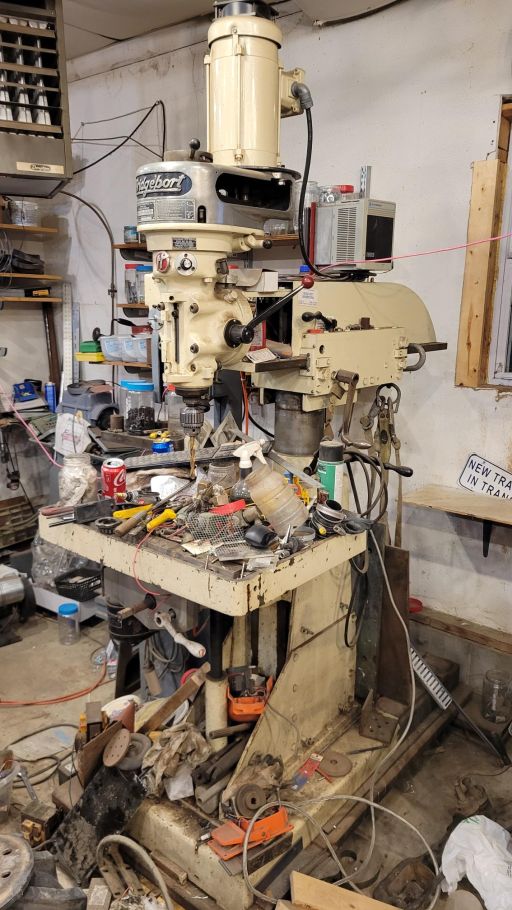

Posted By: DaveKamp
Date Posted: 14 Feb 2022 at 10:12pm
For my usage I can't justify dropping thousands on a new USA made one and the older USA-built used ones I could find for sale were thoroughly destroyed.
Yeah, that happens.  Acquiring this Johannsen set me back $112... I had to scrounge some scrap metal to make the motor adapter setup, the Gates Polychain belt kit (small and large sheave, plus belt) was another $110...  the Allen-Bradley 1305 VFD was $43...  the footswitch introduced itself to me at an auction for $12, and the can of paint was around $15.  I added the table drive motor a year or two later, it's a Bodine 120vac reversable that came out of a small conveyor at a junkyard that I was able to trade weight-for-weight, and it probably cost me 15 pounds of scrap steel.  The spindle lights are little LED under-cabinet pucks, came from the Re-Store for 3 bucks.
In all, I probably have at least $350 in it... Wacko
Yes, it'll drill holes... and power tap.  It has an R-8 taper, so I can use a selection of chucks (keyless and keyed) as well as a Procunier tapping head, a Criterion boring head, and I've got a little belt-drive multiplier spindle for 30,000rpm micro bits. When I'm not drilling with it, It'll securly support a sandwich, bag of chips, and a soda while I'm standing at the lathe... and at that distance, it will ALMOST be far enough so that little swarf chunks don't wind up in my Ruffles.
