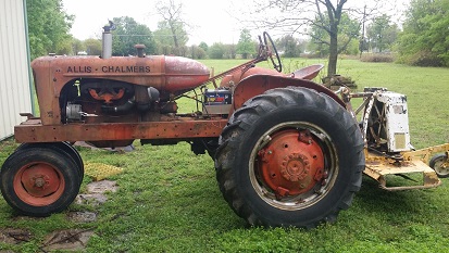

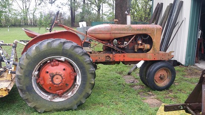

Posted By: mhankins
Date Posted: 26 Apr 2019 at 5:52pm
Posted By: mhankins
Date Posted: 26 Apr 2019 at 5:54pm
Not the prettiest girl in town,awkward getting on and off,clutch pedal hard to reach for a short fatty,smokes some,and hard to keep straight mowing,but I love the old thing!
 It do have a lot of character.

Thanks for the pictures of the 45! Awesome tractors! Yes to all the negatives. A longer left leg is mandatory on one of these. Hummmmmm Chiropractor always said I have one leg longer. I thought it was from some of the ancestors coming from By God West Virginia! Could be a genitic defect to run a WD series tractor?:)
g_g,
