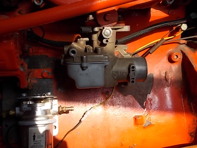

D19 carb on my 45. The Carb was meant to be in the other direction as mounted on the D19 so you have to do some fiddling with it. I used smaller bolts to get it to mount but ensured the intake holes aligned.
http://smg.photobucket.com/user/RangerCharlie/media/WD/20160321_161854_zpsxhnv0zyu.jpg.html" rel="nofollow">
Charlie

Thanks for the pic showing the d19 carb bolted up. Doesn't look to complicated to make work if I only had the carb. Does anybody have the d19 carb they would consider selling. I have no problem if it needs rebuilt. Thanks for all the advice guys!
