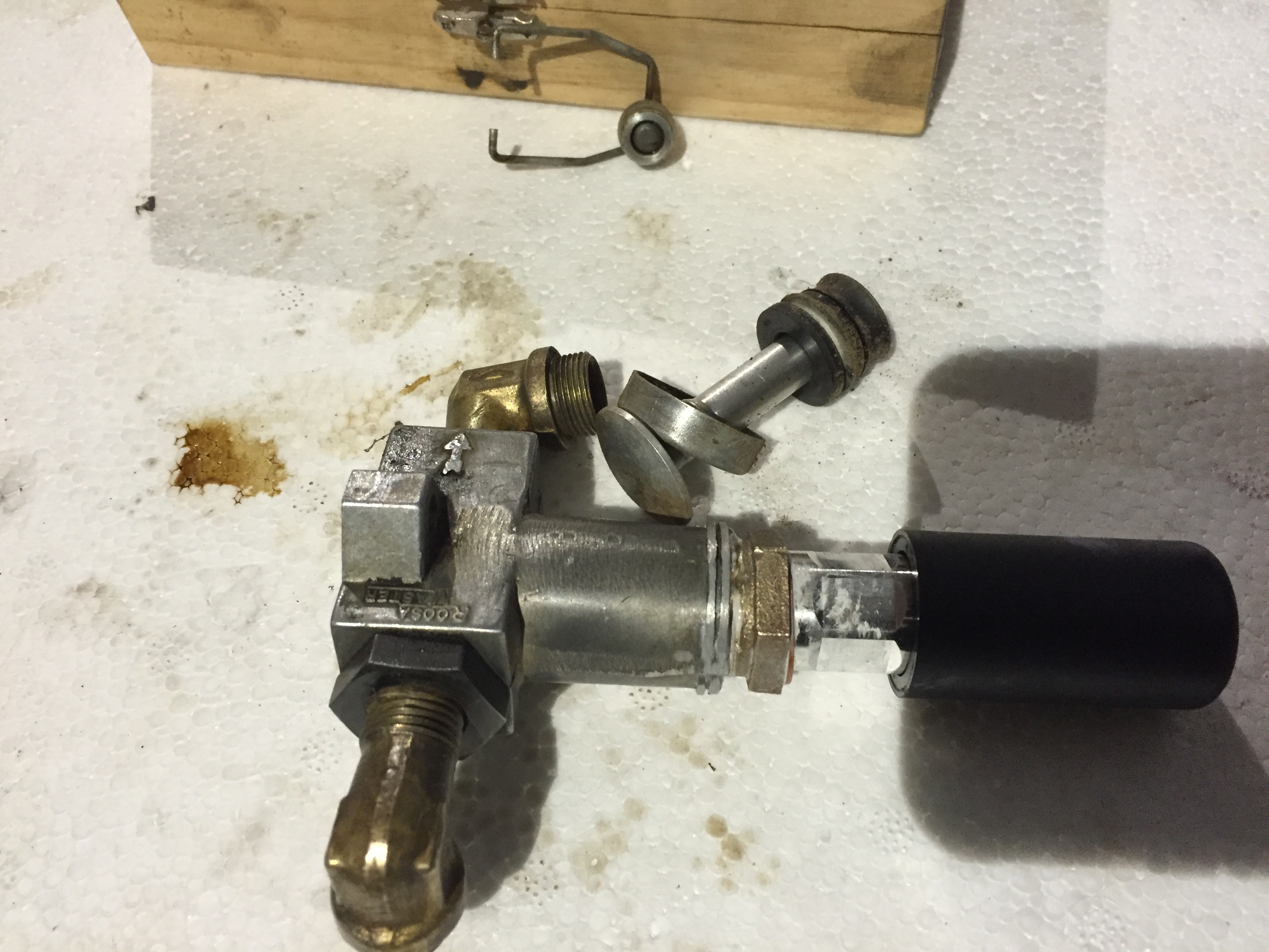

i have a 220 and a 190xt and both have primer pumps that leak as much fuel as they pump when using them. so today i made some changes to mine and got rod of the rubber plunger and replaced it with a sealed bosch pump as used on other tractors. cost about $30 to do the change and about 30 minutes,

darrel, i got the pump from my local pump rebuilder. i have bought the kit from agco but i have always got squirted with fuel when using the pump. with this bosch change i dont get squirted and it seals good.

A quick search for the part number in the picture took me here (I ordered a couple one for my XT and for my 7000 (they both like to squirt too!)

that looks like a pretty good setup, but I sell the complete rebuild kits for the primer assembly for around $70. The plunger is 45 of that. What you don't see are the 2 check valves inside that get clogged up with crap and create a major restriction of fuel flow to the pump. Those check valves are about 10 each. Putting on the Bosch primer does nothing about the 2 check valves inside. New replacement plungers don't leak either. Once that bosch primer is 40 years old, it will be leaking too lol!

Yes Dale,  I only adapted the new pump to the barrel and left all the original check valves and spring intact.  I don't see why you couldn't put in an elbow it should work fine with one I would think if there is room to still pump the pump.
