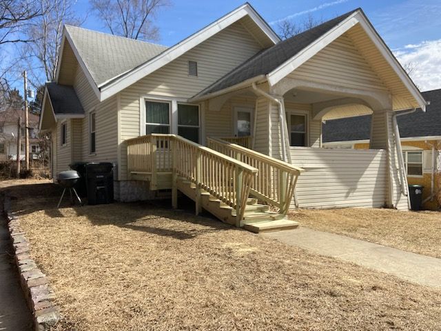

I am trim carpenter working for a Pharmacy in Omaha-we modify houses for accessibility!  Here is one you dont see everyday!  Specs called for half steps (4.25") with 16" tread! I call it the dragon tail!

O my, why not just build a ramp? Would me more comfortable to scale that way.

Interesting design. Should work great for someone who can't handle full steps but doesn't require a ramp. You did an outstanding job on those.

A ramp would have been 38’ long! Omaha won’t allow that size ramp in the front yard

Greg IV done similar. A lot of times here in the Ozarks the steep terrain won’t allow for a ramp to code.
I have built a couple with 3 switchbacks due to the terrain.
You sure did nice work on this one.👍👍👍

nice ! but I'd have fixed that buckled board on the deck....sigh.. that really shows next to your fine work !!

Greg... my wife has trouble with 8-9 inch steps... That 4.5 inch would work great for her.. I did build a ramp in an enclosed porch area for the neighbor... Only had room for 10 to 1 slope so i did that...it is U shaped double back.... They love that also.... No "regulations" where i live.

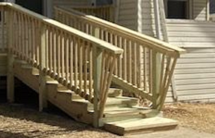

The steps/risers look AWESOME !! It's the height of the handrails that have me giving a "double-take", in the pics they look to be 42" high ??
And there's no actual "gripping" for a hand to grab ???

i re-did my front steps from our deck that way, put a 2x8 and a 2x6,one in frobt of the other and screwed them down to a landscape timber with a 1x4 under it, made great steps up to our deck. yours look alot nicer with the hand rails. good job!

About stuff I did not fix-this is a State funded assistance program.  We are not allowed to do ANY work, other than the spec sheet we bid on, without our program contact giving approval! That is so we don't come in low and then suggestively sell our way into a large project.  If we do that we risk not being allowed to bid on future projects.  Not all projects are in low income areas, but most are.  There are lots of things one could improve on at most of these projects.
