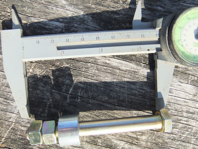

Post Options Post Options   Thanks (0) Thanks(0)   Quote BigGuy1000 Quote  Post ReplyReply Direct Link To This Post Posted: 10 Jul 2022 at 8:43pm
Applied the above bolt (3/8 X 3 1/2 GR8 NF, GR8 fine nuts with 1/2 in long bushing) to the ac175D trunnion.  Bushing is next to the trunnion.  Nuts are tight against each other, but are backed off one full turn from the bushing.  The threads are entirely outside of the trunnion.  It has not broken in more than 2 years now on loader duty!
I will declare this fixed, WITHOUT needing to buy or learn a big expensive welder!!!!
