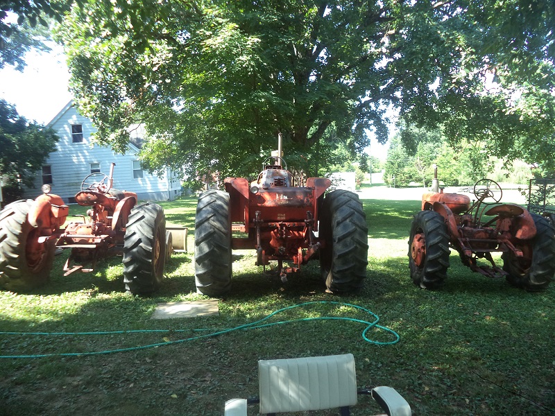

The tractor on the left is my WD45 with 16.9x28 Armstrongs on 12" rims. The tractor has worked liked that since the 1970s albeit the tires previously on it (unknown brand) did look more normal than these L/S bar tires do now.

Post Options Post Options   Thanks (0) Thanks(0)   Quote AC720Man Quote  Post ReplyReply Direct Link To This Post Posted: 16 Jul 2021 at 9:37pm
Mike, that’s the first time I’ve seen front tractor tires balanced.
