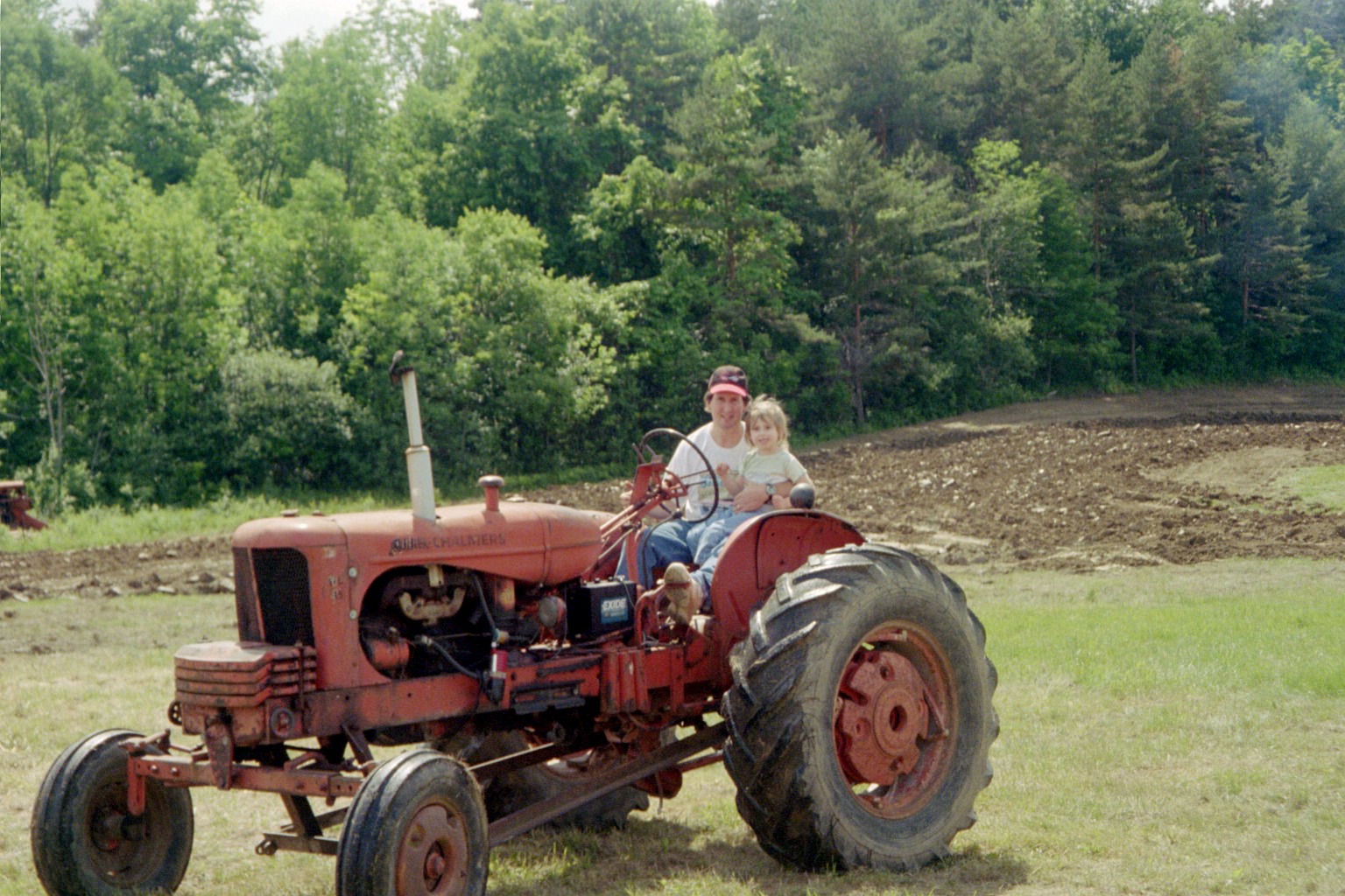

It has four stack weights on it now!!
The 3-16 SC plow that Dad had for this made her work. I only plowed up his garden spot once the first time at his new house in town. She seemed to hold her own pretty good when plowing though I did feel the front get a little light at the end of the furrow when I first hit the lever to raise the plow up. The XT was the main plow tractor by the time I was old enough to do so thus I never got any field experience plowing with the WD45 myself. Dad did though with this and the WD which I also still have. He always said that the 45 was nicer to plow with obviously because of her extra power allowing her to run a gear faster even if it meant the front getting a little light whenever she hit a good patch of clay. That being said, he also always gave kudos to the old narrow front WD which would pull that same plow, albeit a gear lower, but he never had as many issues with her front end coming up. The WD has no front stack weights at all but does have a pair of front wheel weights the same as is shown here on the 45.
