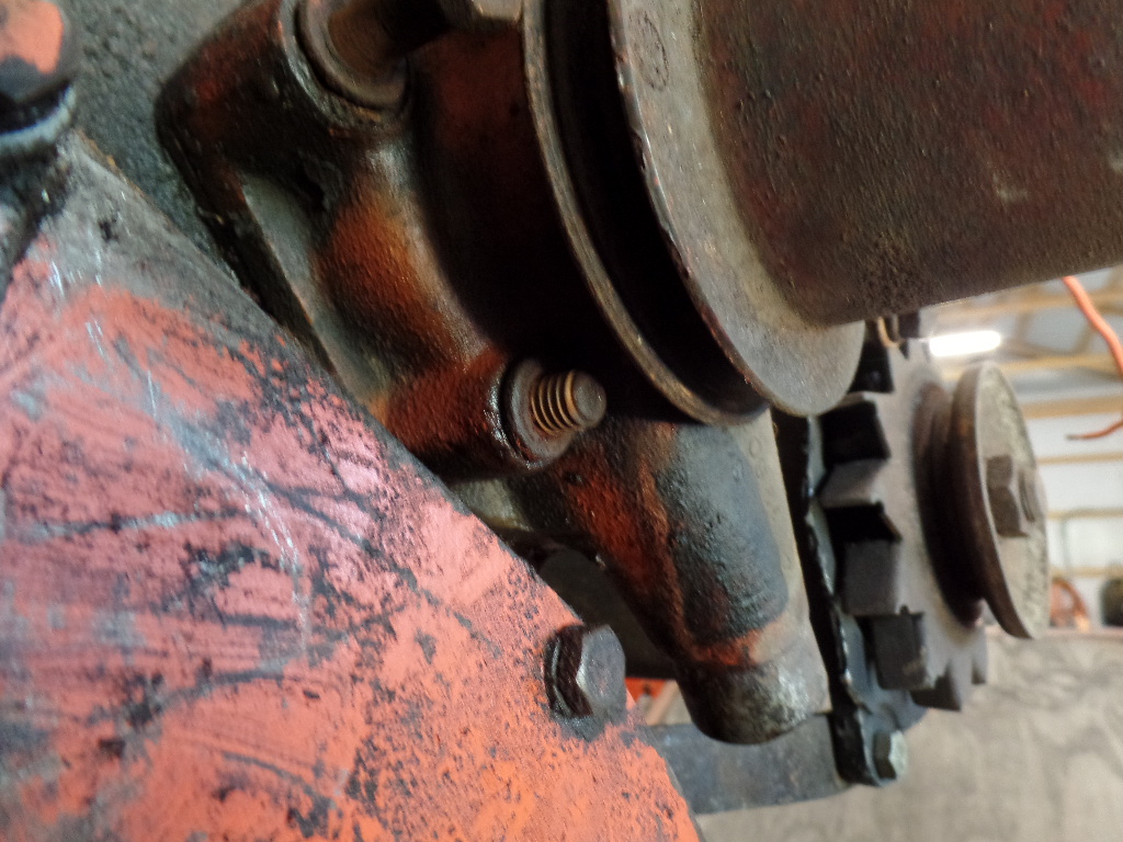

This water pump has two normal bolts.  The third fastener had a nut on it and when I removed it, this stud was left.  It appears to be screwed into the engine block.  Not sure why someone did this....I'm guessing it's supposed to be a bolt like the other two?????

Looking back at my pics it looks the same . Guess it came that way . HTH

So that stud does NOT screw into the engine block?
If it does, how do you get it out.
I've got the other two bolts out and the pump still feels like it's attached....I'm prying on it with a big screw driver to break it loose.

Just checked my old pump . It has 3 bolts/nuts holding it to the block . If they're loose it should come off .

The stud would aid assembly. Probably rust between the stud and pump housing. Soak it with penetrate and try twisting the pump back and forth to get the rust to break loose.
