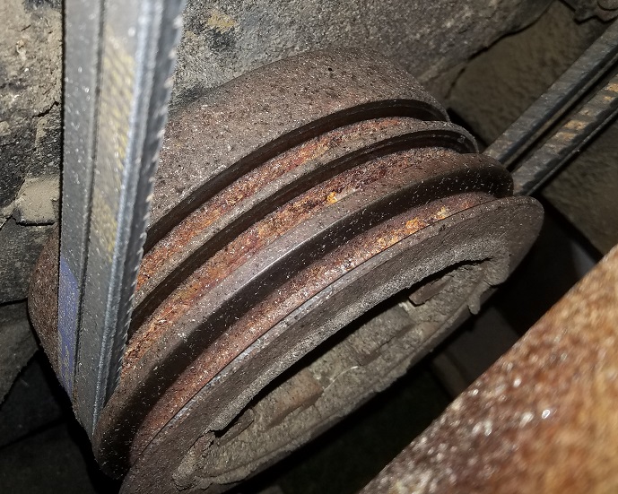

Here is what the pulley looks like.  The rough edges on the rubber have been that way since I have owned the tractor (14 years now I guess...).  Now signs of it shifting back or forward.  Double belt for fan/alternator appears to have good pulley alignment.

Post Options Post Options   Thanks (0) Thanks(0)   Quote Red Bank Quote  Post ReplyReply Direct Link To This Post Posted: 16 Jun 2018 at 8:50pm
Yours looks fine so I don't think that's the problem. I was just offering the advice because it just happened to me. The compressor mounts and bolts are all ok? And will it throw the belt without having the A/C on?
