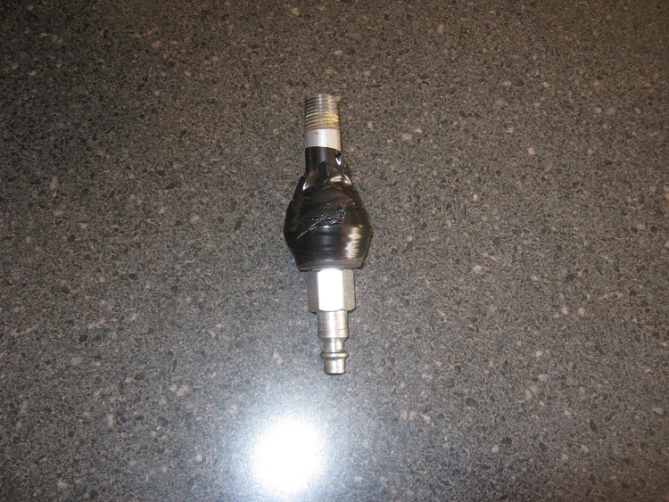

Post Options Post Options   Thanks (0) Thanks(0)   Quote Tim NH Quote  Post ReplyReply Direct Link To This Post Posted: 11 Jun 2017 at 6:05pm
I didn't have good luck w/ my OSHA approved air blowing nozzle. So I made up a gem. Set regulator at 60 lbs. In 2 seconds I heard the 3 pt hitch come up. The steering worked, and the light is off.  Thank you Mack.  Tim
