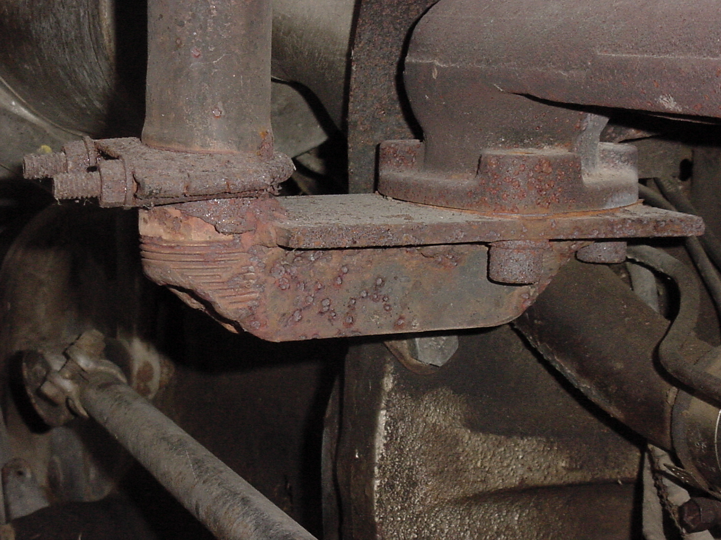

I have an old undershot muffler off the 8N, and I want to put a bend in it so I can convert it to vertical (so I can run a All-Crop with it). How do I go about doing this? I tried it once before, and even while being very careful with low heat, it developed a hole in the pipe.
Anyone ever bend exhaust tubing and have a good method?
Thanks!

Exhaust pipe bender I the only way. It would be easier to buy the bends and weld or clamp them together.

that's what I do.. buy a 90 degree elbow and wire feed weld it as needed.

Creston, you can fill the pipe with sand, then heat and bend it around a round object. You'll only have moderate success doing it this way though.

if your after function not form,you can heat inside of bend and make a wrinkle bend

I'm after function. I might try that. I'll only use the vertical muffler for a couple days, only because the farmer who owns the field where I'm combining doesn't want the undershot muffler in his field. "Fire danger".

OK.... how about ADDING pipe to the end of the original pipe ? Something bent like a 'J' that slides onto the existing pipe and bolted to the tractor. Maybe a pipe clamp to hold it onto the tail pipe.
This way, after harvest, you can unbolt the 'extension' and hang up in barn until needed. the tractor would become 'normal' again.
