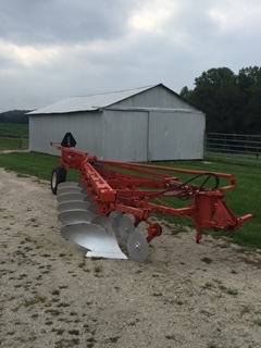

Looking for truss tube extension & spring trip for 9000 plow. Also would like to locate 7 original landslides.Thanks

I assume the 2000 series plow are different?  You all know what assume means.

The 9000 plow frame is covered in the plow frames book linked in AC Plows Parts 101 over in the Knowledge Base.
In the plow bottoms book on that same links post, it appears that all plow bottoms used the same land sides, the only variations in land sides were lengths, short for front bottoms, long for rear bottoms on plows without a trailing in furrow side thrust wheel.

9000 has 5"x7" box frame, AGCO dealer could not tell if 2000, 3000 or 9000 frames were same size? Allis-Chalmers AD shows D 21 pulling 9000
7/16", on-land hitch, semi-mounted plow. Trying to keep original. Any contacts appreciated.
