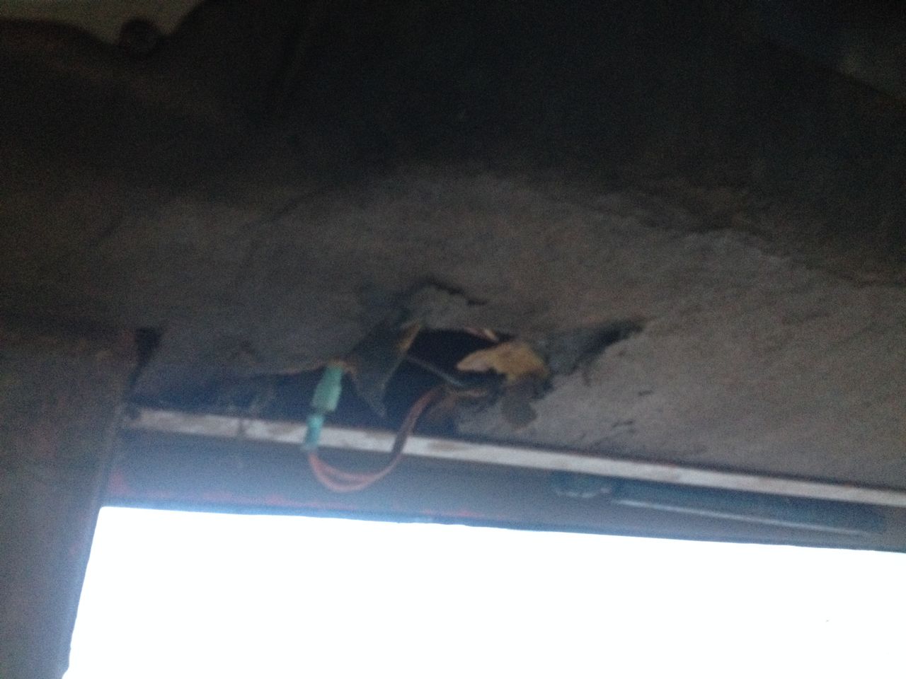

-a sensor to the right of the 3 point hitch is unplugged with the wire dangling - whats it do?

All of the 8030 have the dual pto shaft, unbolt and reverse to get the 1000 pto. Wires back by the 3pt are for wagon/trailer lights. For that price you can replace the interior so it looks brand new. I have been more than happy with both my 8000 series AC. The powershift and Power director transmission are both great. You should really like the tractor.

Its not all light wiring, goes to a hydraulic block on the right side of the top link casting, just left of a big filter can by wheel, sensor looks like an oil pressure sensor and there seems to be an adjuster above.  I'm just concerned the low pressure light or filter change warning light was on and they unplugged it to help sell.
My MF has a pressure sender on the canister for filter warning light but this is over a little bit.

Not sure but could be safety switch on pto, I not sure where you mean but there is a safety switch on the back so you can't start it if pto is in gear.  Almost sounds too cheap to me, makes me suspicious of something.

Re the switch it may be pto related, its left of the linkage rod for the 3 point hitch that runs vertically.

If it's unplugged where the wires are in the first picture, the PTO safety switch has been bypassed so the tractor will start with the PTO in gear. If it's unplugged like in the second pic, it's because that switch has gone bad like mine an you can't get that switch anymore. It's for the transmission filter being plugged up.

It is the plug from the first picture.  Not sure why they would need to start with PTO engaged, maybe it was on a manure pump at some point.

If the white wires are unplugged from the PTO switch, the tractor shouldn't crank over with the starter. The wires would have to be hooked together (jumped) for it to start from the cab.

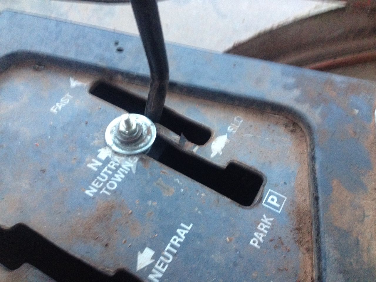

Yes whirring and clacking from down below.  I've driven other high hour tractors that sounded like that for hundreds of hours but its not confidence building.
Park postion blocked out with washers as well.  See some of my pics below.
