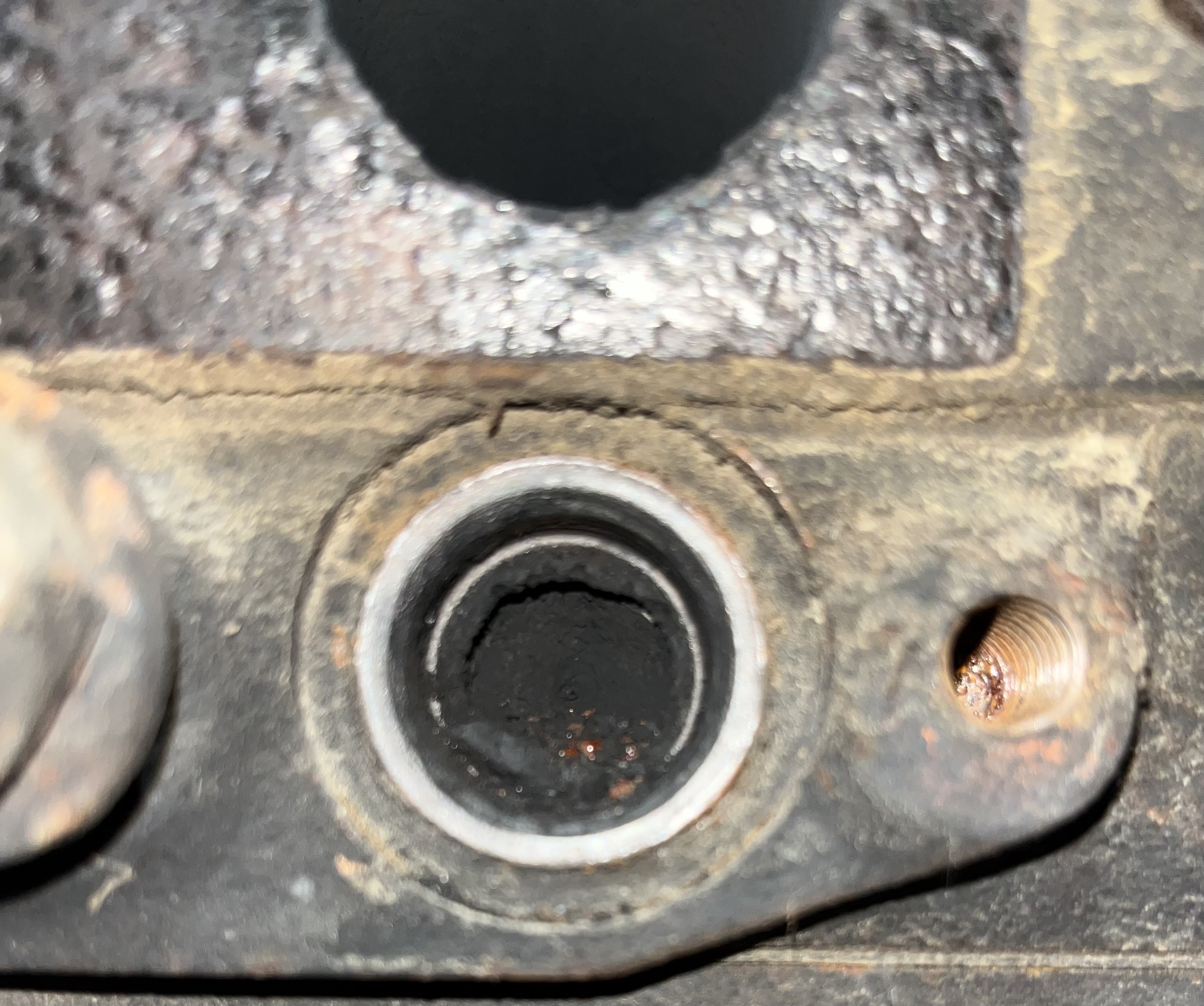

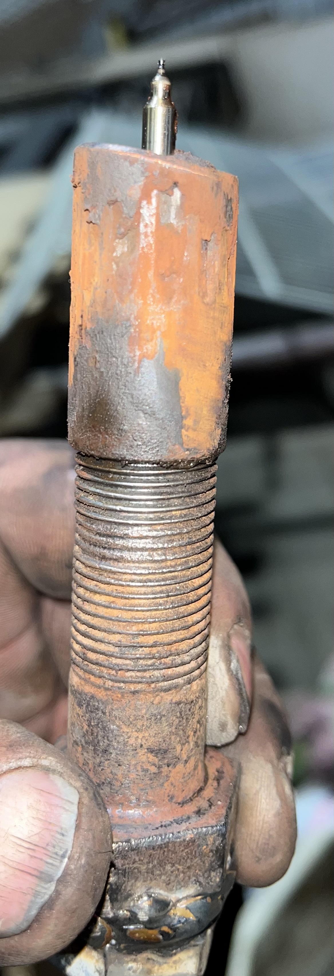

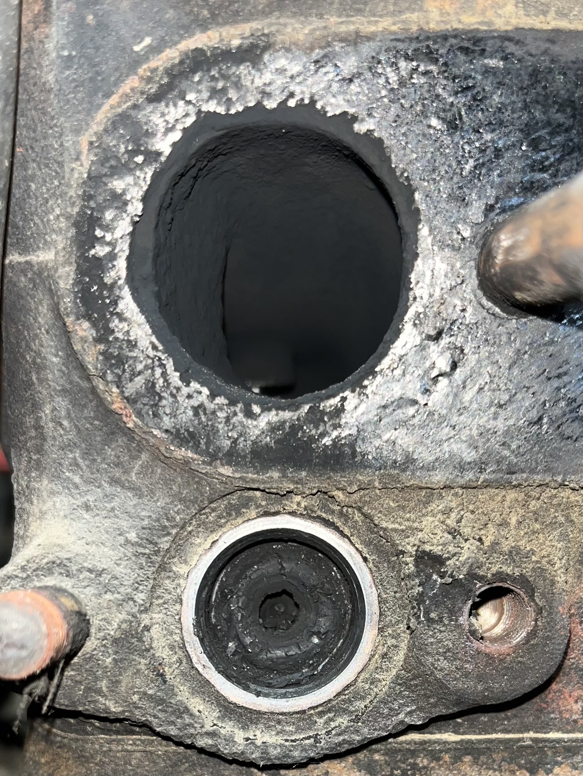

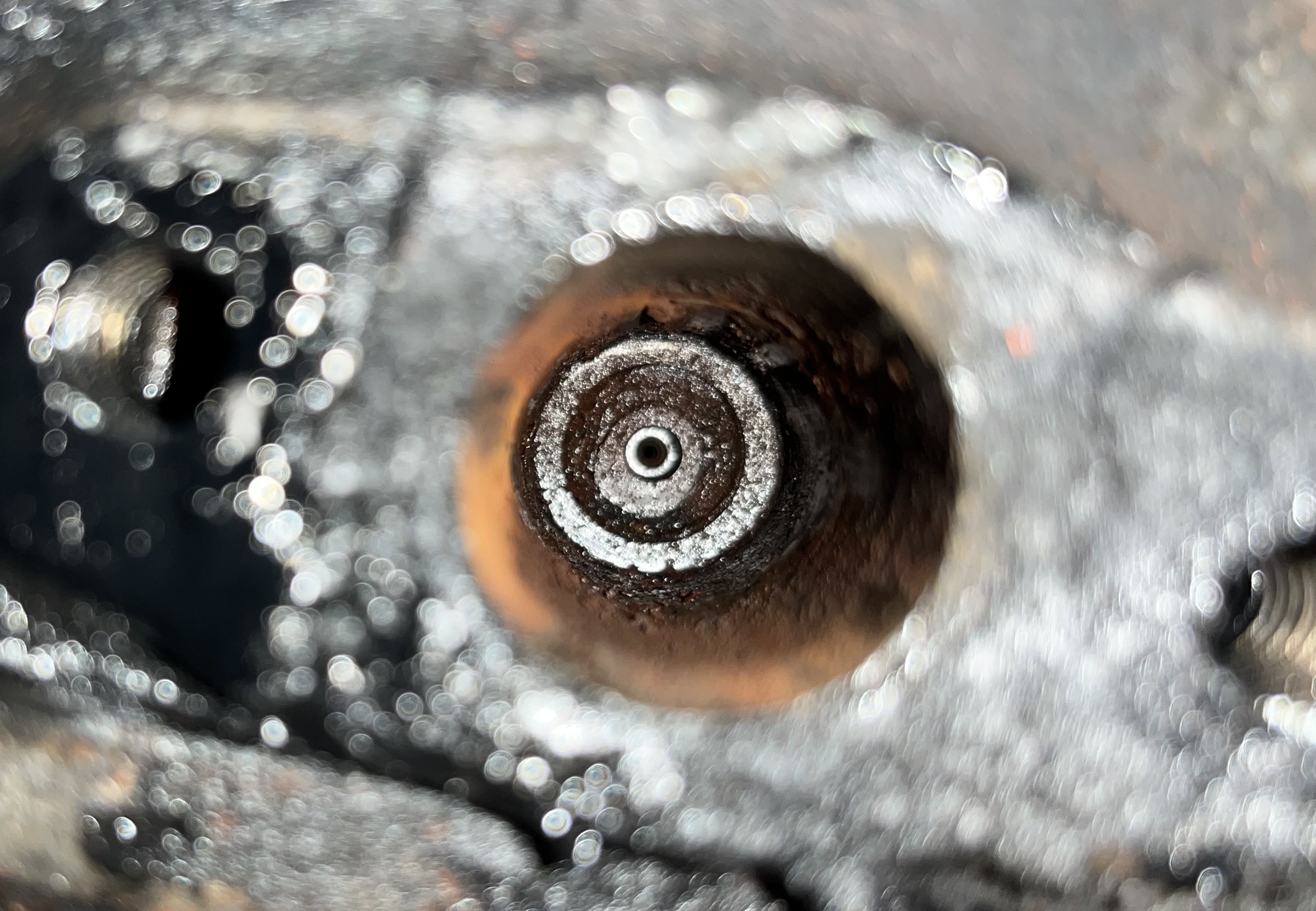

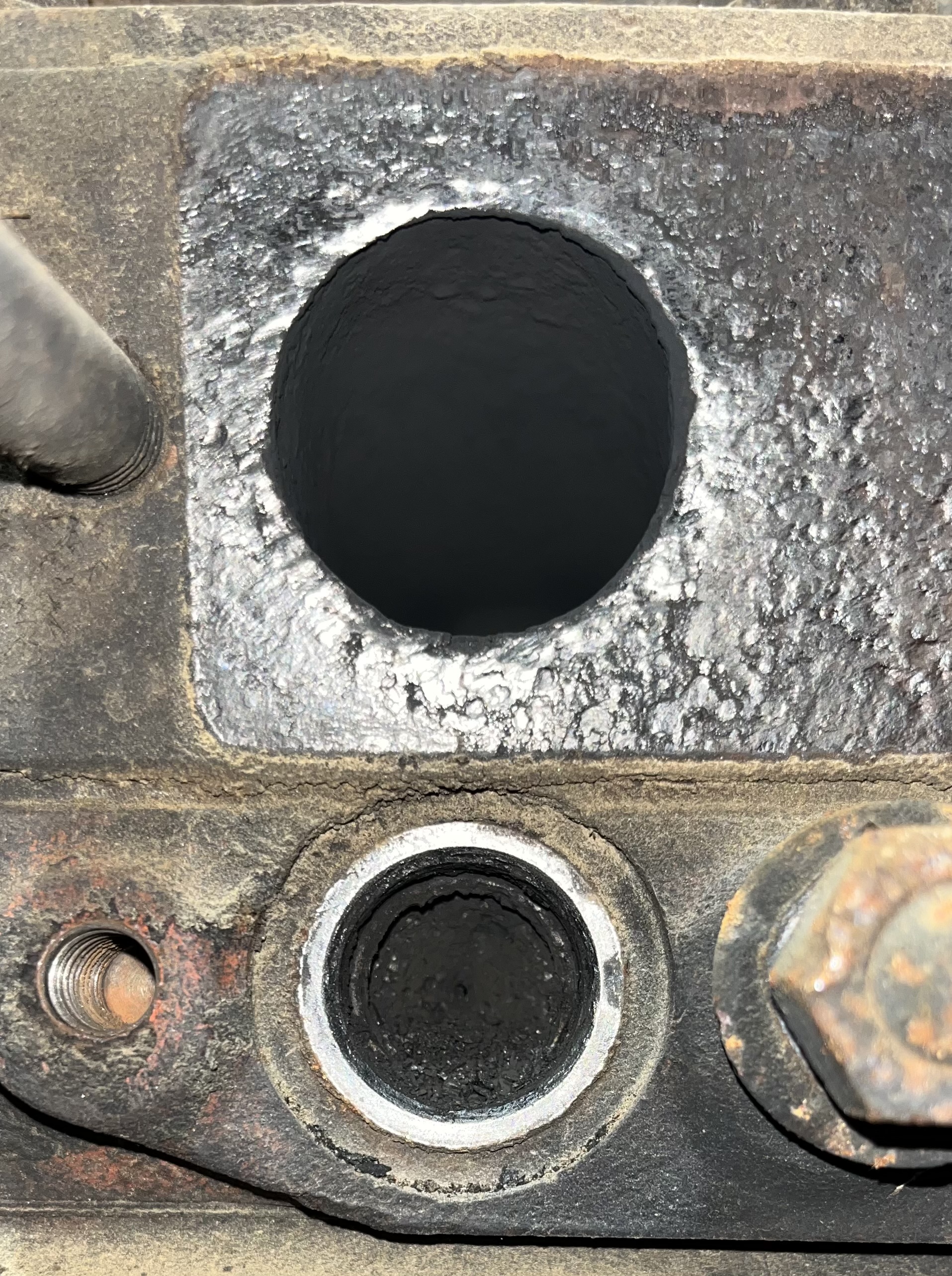

I have a D19D that has been running ruff and smokes bad. I don't know any history on it so I pulled Injectors and looked through to see if I could see the energy cell holes and 4 of them were plugged so I pulled the caps and they were clear full of carbon. I cleaned them up with a pic and had to drill the carbon out of the hole. Is that going to be sufficient or do I need to do something else? I had to pull 1 out to punch out a Injector tip that broke off.

You could send off to a head shop and have them boil it and while it’s there have them pressure check it.

I have a YouTube video of energy cell repair on my neighbors D19 a year a or 2 ago. It was a good learning experience. My suggestion is to watch it so you can see how to remove the cell to clean and inspect for damage. It’s not difficult but care is required so you don’t damage the cell. With the amount of carbon build up I would suggest removing them to clean. I would not use a pic. They are expensive to replace but are still available from AGCO. The cap must seal against the cell to prevent leakage which was his problem.

for sure the pump and injectors need to be done .  the rockers are probley wore out and need to be ground so that the lash can be adiusted proper ,    how many cylinders are useing coolant ?   .  if the head isnt off allready and get those things done so all the cylinders are doing their work  that  will probley make enought presureses  to make it it use coolant or create crankcase blow by

My opinion:  If this is a tractor you expect to make $$$$ with, stop the project right now. It isn't worth the $$$$$ it's going to take to install a better cylinder head, injectors and OH the injection pump.

I would say the pump and injectors need an inspection and most likely a rebuild to get it back to factory specs. Something is obviously wrong for this amount of carbon buildup to happen. Ed rebuilt my pump a few years ago. She starts easy and runs really well. I mainly use it for sickle bar work and hay raking. Also occasionally run our square baler.
