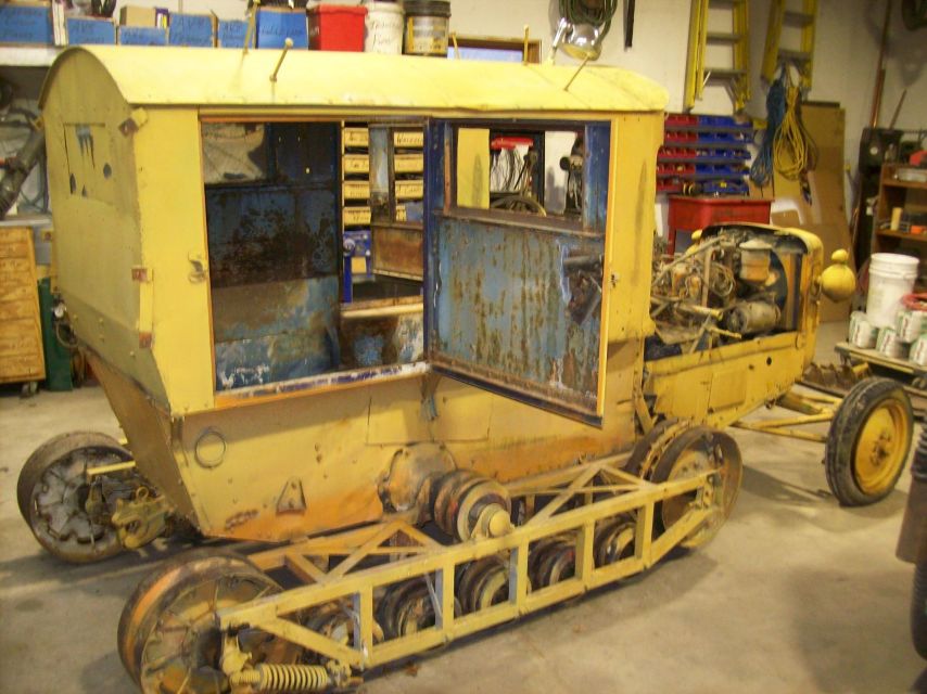

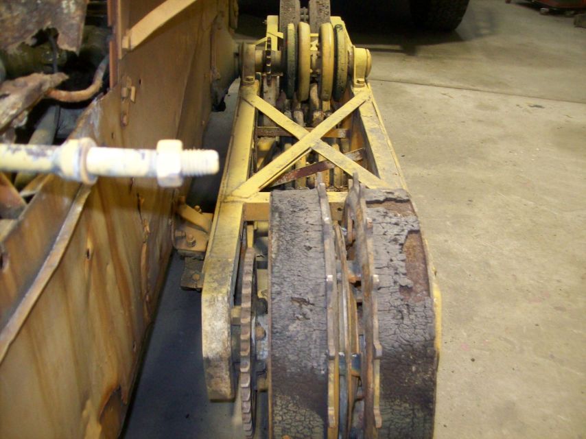

Picked up a new project today. Not sure if the picture will work or not? Anybody know how many pads make up a full track? I'm guessing some are missing.

That looks like one of the South Pole transport machines.

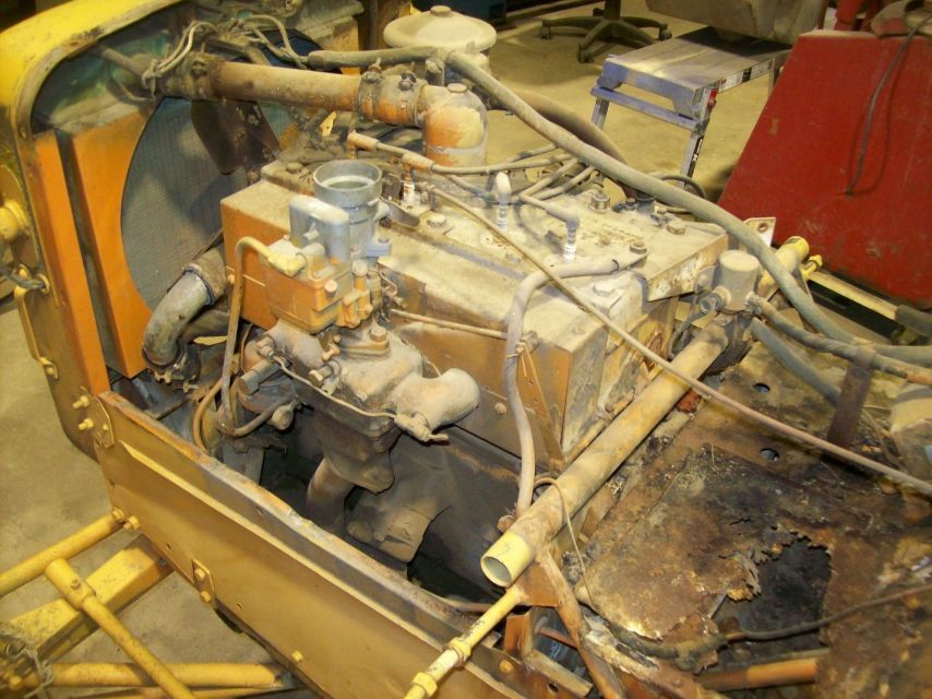

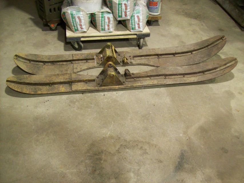

There were 291 of these built in 1944 for the military. The motor, tranny and rearend are from a WWII jeep so that the military had parts on hand for them. The grill is a B grill widened about 10". It's chain drive from the rearend to the track drive sprocket. These skis are steel but the originals were wood. Has individual rear brakes with both hand and foot throttle. This one was used by a power company for years and then possibly a hunting rig since it has gun racks inside right now. Not sure at what point the cab was built for it and I have to decide whether to keep that or remove it.

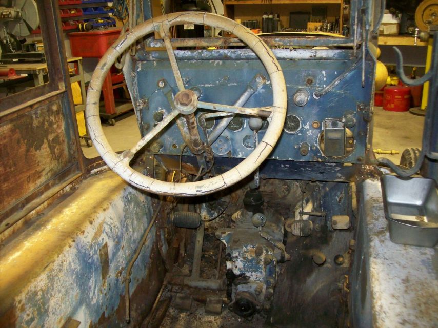

i would say that the cab has to stay ,  is that a small pocket transitor radio hanging on the dash

Thanks for the reply on track tread count. That means I am only missing one tread.

That thing on the dash is actually an ash tray that someone added.

Not sure how long its been since it was run but today I got it running. Smoked pretty good but had 60 pounds of oil pressure. Probably some stuck rings? Now the search will be on for one track tread. I would like to drive it before I tear it down to restore it just to check for anything not working like it should.

now i see the ash tray

Got good news today. The guy I bought the M7 from called and said they found the tread I was missing for the tracks so now I have a complete set. I'll go get it this weekend and then I just need a picture from someone who has one and I can start rebuilding them.
