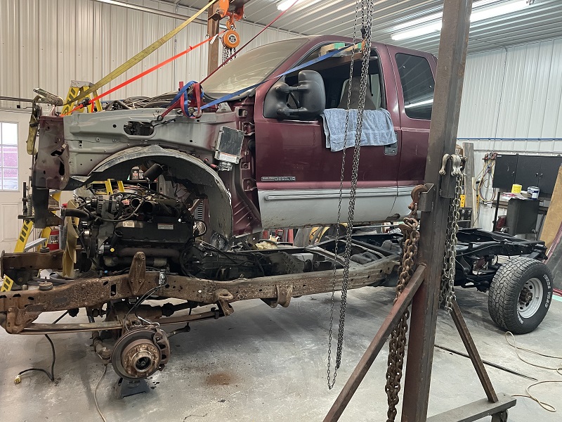

If is as my Super Duty was, this was ONLY way to change Turbocharger.  Core Support panel and Internal Fender system does not come off.

Went to visit a friend awhile back, he runs a small auto repair business. He had one of those big Ford Expeditions in there with the body suspended above the chassis to R&R the fuel injectors.
He said it wasn't nearly as difficult to pull the body as it seems, and nearly impossible to change the injectors with the body in place.
