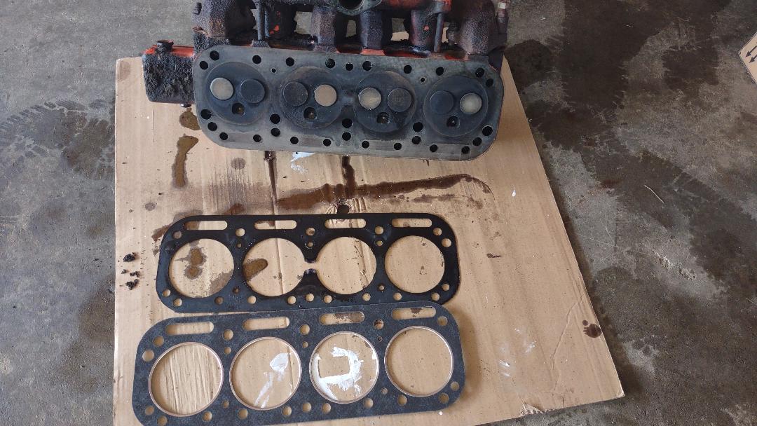

Blown head gasket almost for sure. While taking it apart, check the valve lash and as long as there aren't any tight (#2 and #3) it's a blown head gasket. Best fix these days is use a G-149 gasket from a D-14 early D-15.  Could also be stuck valves on those two cylinders, but again while disassembling a good Tech would check for that before just ripping the cylinder head off.

I bought a D15 II that was like that. Blown head gasket. Make sure to get one that has fire rings on it. HTH Tracy

I had almost exact same situation with a D15 II.  I finally fogged the cylinders and regained the compression.  But having 2 adjacent cylinders does indicate a head gasket. I use the Victor Reinze that have the fire ring.

I finally got time to tear it apart today and the gasket had no fire rings and was blown between #2 and #3. I know I probably should have had the head flattened, but I put it back together without resurfacing. It runs much better!
