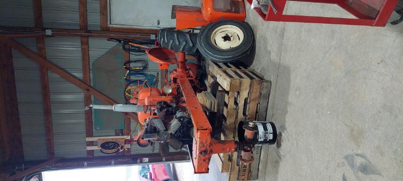

Posted By: jmrehn
Date Posted: 22 May 2025 at 6:20am
Thank you Mike, Got this far with it yesterday,Got to figure out how to get it out of there now,and catch it.
53WD
Posted By: WF owner
Date Posted: 22 May 2025 at 12:06pm
Some free advice (that is probably worth what you paid for it!).
I found the easiest way is to remove the left frame rail (left is easier so you don't have to mess with the belt pulley). After you get it loose, drive a chisel in to separate the frame rail.
Before you put a lot of pressure on the 8 bolts at the front of the frame rails, rap them a few times with a 3 lb. (or bigger) hammer to break some of the bond. They have probably been on there for close to 70 years and I have seen a lot of them broken off.
It looks like a lot easier job than it actually is.
