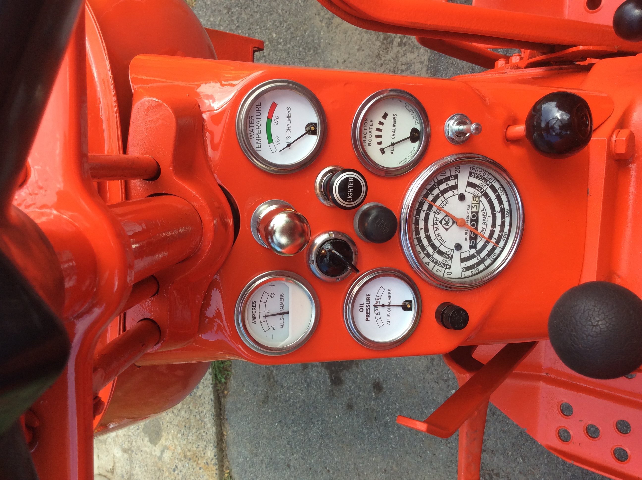

Posted By: Lynn Marshall
Date Posted: 15 Sep 2023 at 7:50am
Are the wires on the ammeter reversed?

Posted By: AC720Man
Date Posted: 15 Sep 2023 at 11:43am
I had just pulled the light switch on when I snapped the picture that’s why it’s showed negative in the picture. Genny picks right up to positive charge.
Mmmmm....will need to see how to change that on my tablet Steve. I guess also makes it easy to see all my flaws lol
