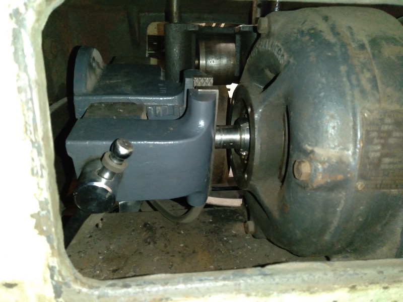

I popped the end cap off the non-drive side of the motor and decided I should at least regrease the bearings (Dave - this bearing at least seemed to be tight and in good shape). No corrosion, but the old grease is pretty dry. I'll try to pull off the drive pulleys on the other end so I can inspect/regrease that bearing, too.
The pipe plug in the end cap goes into that cavity - however, the center of the end cap is open to the world. I'm thinking some sort of expansion plug or something fell out of there, because it should be holding the grease in place. When bolted in place you can see/touch the end of the motor shaft. Glad I caught it now when I have the grinder away from the wall and this stuff is easier to access.

THAT is a different pipe-plug arrangement than what I was envisioning.
That bearing looks like an adjustable, but I don't think it is... but it may have provision for some sort of preload or preload limitation.
IF it is the SPINDLE motor (not in the base of the machine) then that's a high-precision/close tolerance bearing system.  If it's just a motor with a belt sheave, then it wouldn't be a big deal.
There is one comment about single vs. 3 phase on grinding centers... surface noise.  On direct-motorized spindles, the magnetic action of the armature causes some harmonic motion to appear in the spindle as the motor runs, and that harmonic motion can cause the grinding wheel to deflect slightly, and gyrate while it spins.  Guys who do extreme precision work will note the wheel's gyration will leave a 'pattern' on a part as it cuts.
I don't cut anything to that precision, but I have seen that sort of pattern on parts placed my optical comparator screen.  If you were making high-speed spindles, or scientific equipment, it might be a problem, but if not, doubt you'd care.

I'm still not sure I fully understand the end cap. There is also a slotted flathead machine screw 120 degrees apart from the pipe plug, in one of those slight bosses in the cap by my fingers. The third boss is undrilled. Regardless of intent of everything going on there, if I seal that open end hole back up, it should hold grease properly... Although now I'm wondering if there was something in that end hole that allowed grease to pass to the outside, away from the motor, when enough pressure was reached while it was being greased? If so I'll just have to be careful not to overgrease if I put in a hard welch plug or similar.
No context in my photos for sure... all close ups. This motor is mounted to the bottom inside of the base casting, with a 3 v belt drive from the motor to another shaft, which then drives a flat belt that snakes all the way to the spindle up top. So, these motor bearings shouldn't be extra critical since it's not a spindle motor.
There does appear to be some sort of adjustment nut with a staking washer on the end of the shaft for bearing adjustment.

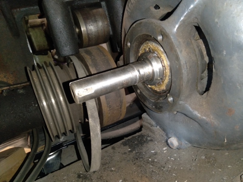

Getting back to this thing, and hopefully back on to the WD.
Getting to the shaft-side bearing has been fun. The pulley fought the whole way off the shaft, and no room to get a puller on the end of it. I was eventually able to work it off. Managed to sneak a vise in there to hold onto the shaft and was able to knock the bearing locknut loose. I maybe should've pulled the motor out, but that thing has to be heavy and I wasn't excited about wiggling it out of the base of the machine.
Turns out the bearing locknut and washer are the same size as the one on my Super M's M & W hand clutch, so I'll order some for spares.
Still have to get the actual bearings out to clean, inspect, and hopefully they are good to regrease and reassemble. I'm worried I may have to take the ends of the motor housing off to make this happen.

john... i dont know the condition of the bearings, but you might be able to use an air blow gun and blow the old grease out between the balls... Pump some new in and roll the motor around to distribute... them old bearings are TOUGH and last forever.

Steve, I think that is my plan now. I started to put a bearing puller on one end to pull a bearing off, and then got to thinking about how I'd get the bearing drawn back on there without putting the shaft in a press... I'd probably have to clamp the shaft solid again, and hope I could pull it on with one of those locknuts. I'd buy a proper wrench from SKF but they're all side access so in order to get the wrench in there, I'd have to pull the shaft out.
This bearing on the non-drive end of the shaft feels very good. I'm going to protect the inside of the motor with some plastic or similar so I can spray brake cleaner in the bearing to wash out the old grease that's left, then repack with some Mobil Polyrex EM that I bought specifically for electric motor bearings.
Posted By: wjohn
Date Posted: 24 Dec 2023 at 10:04am
The bearings were both in great shape. Cleaned them out as best as I could and repacked with the new grease. When I get a VFD ordered and can run it, I'll pump a little more grease in and open the lower grease plug and run the motor for a bit. There's a pretty good guide from Mobil on electric motor lubrication here that answered my questions about how to grease this style of bearing cap with two plugs:  https://www.mobil.com/en/lubricants/for-businesses/industrial/lubricant-expertise/resources/electric-motor-bearing-lubrication" rel="nofollow - https://www.mobil.com/en/lubricants/for-businesses/industrial/lubricant-expertise/resources/electric-motor-bearing-lubrication
After cleaning up the shaft, key, and keyway, the drive pulley went on much easier than it came off. I also replaced the key for the power table feed drive pulley and now there is zero play between the pulley and shaft... So I think I just need to buy another flat belt if I want that feature to work. I'm guessing I'd only use that occasionally on cylinder heads or larger items like that, but I think it could be handy.
I just need to keep chipping away at cleaning and assembling the grinder now. I also need to run my conduit and wiring for the 220V and decide on a VFD. For this size of motor (1.5 HP) cheap VFDs are only ~$100.
