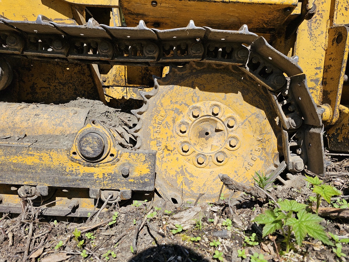

 Just to show what I'm dealing with, I turned the tensioner into the yoke about 1" to the end. At this point I don't think I have any choice but removing a link if I want to use the Dozer.

This is a pic of the left side I have adjusted to the factory 1 1/2" of sag. The tensioner rod is adjusted completely out of the yoke and only grabbing on the lock plate. Notice the front of the slide is completely forward, even the front bolts were removed on the shims to allow it to move further forward. So even if I shimmed the tensioner rod there is only about 1/4" the idler wheel could go further forward, but then the issue of the tensioner rod allowing the yoke to move around would still be a problem.

The rode adjustement right side is adjusted correct and we can see the tread on rod but the left sde we can't se any traid he is complet desajusted we should see the tread on rod .

Is the parts wear pretty even side to side on the undercarriage, or is the right worse than the left? From your first photo it looks as you may have a skipping problem with the chain and sprocket wear once the track is tightened up. I'm not certain you will be able to fit the track with a link removed as Steve pointed out also. Thinking I would fabricate another adjusting rod of additional length to tighten them up and prove the tractor worthy of further investment?
As a pushing dozer, worn out street pads will do you no favors and it looks like the track pad capscrews are just about the same height as the pads from wear.
Posted By: Vetter
Date Posted: 04 May 2022 at 8:30am
Yes, the wear is even on each side.
The little bit I drove it, the sprocket didn't skip.
And yes, even the capscrews are worn. The problem with making an extended tensioner,is there is no more forward adjustment, it's maxed out now.
So really, the cheapest alternative right now is remove a link. There's plenty of slop right now that removing a link should be no problem.

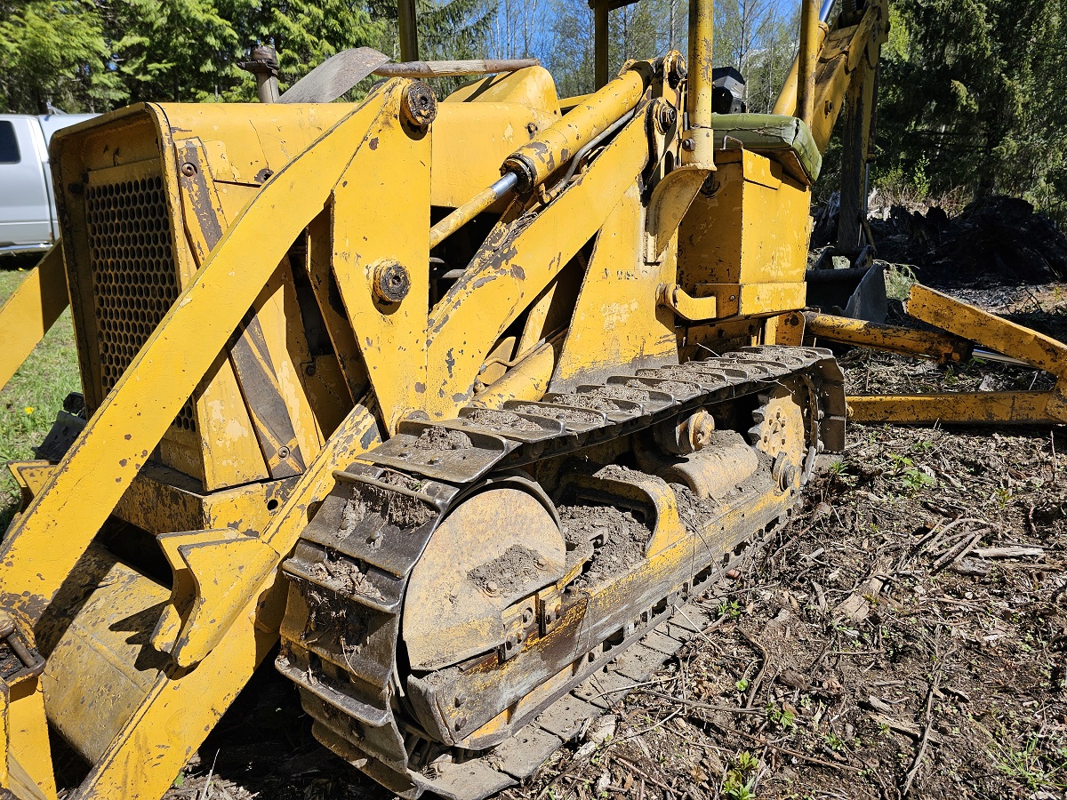

Your left side track is facing the wrong way - and also it looks like sprocket teeth are SHARP and worn beyond limit .
 Track pads are loader pads not dozer -
Kind of a point where it might be a time to find another owner rather than chase good money into something - One reason my H4 got traded off - became anothers problem and not mine
Posted By: Vetter
Date Posted: 04 May 2022 at 3:10pm
 Thanks about the track info, I didn't even notice that. I did know about the loader tracks, I assumed that was original because it was setup for a backhoe too? My initial intent was to weld on some grousers eventually, but with all the wear that isn't going to happen.

In closing, here are some photos of my machine. I think the sprockets appear to be in decent shape still, but that's just based on pics I've seen of other machines where the sprocket teeth look like they've been worn down to the point of looking like sharks teeth.

For the life of me I can't see how removing a track link can change the contact points on the sprocket, not saying it doesn't happen, I just can't see how? I understand the wear has changed things, but that has already been done and I look at it as the sprocket and links have wore together. Like removing a link from a motorcycle chain, it shortens it, but doesn't change its geometry? I know that's is over simplifying it.
 I'll look into flipping the bushings and pins, but I'm not sure that would be enough to remove enough slop for the tensioners to thread into the yokes properly.
[/QUOTE]
Well, yes and no.
Removing a link allows you to take all of the slack out of the chain; the chain has already 'stretched' due to wear, and if you pull it tight like a fiddle string then each link is now slightly longer, thus preventing the bushings from settling down into the sprocket.
The contact point is now higher up on the sprocket tooth and above the previous wear area. Since the same amount of force is now concentrated in a smaller area, this area will wear more rapidly than before, hastening its demise.
If the pins and bushings have never been turned, it will indeed help to have this done because the bushing area would then fill the sprocket more fully, plus the pin and bushing contact area is at a different spot inside. The chain will appear to be shorter.
If the pins and bushings have already been turned, then your options are now:
A) Run it as-is and hope the track stays on
B) Find a better set of tracks (good luck with that!)
C) Park it and use it for a yard ornament
D) Scrap the machine
E) Remove a link and get what little life remains out of your machine
If you do remove a link, run the tracks as loose as you can get away with
[/QUOTE]
A stretched track washes out your sprocket because it lengthens your pitch. Pitch has nothing to do with the number of links you are running.

Looks like a very versatile little machine and they certainly were handy in their day. They did better in sloppy dirt/mud than a rubber tired backhoe loader many times.
I do see a lot of wear in your undercarriage. The sprockets have probably been changed when the originals were "skipping" from the bushings wear, or wear through as they have been run that way quite some time. To me, the sprockets appear to be much newer than the balance of the undercarriage. I also see a lot of wear to the chain links and front idler in the photo. Much of this can be built up, or rebuilt, but the simple truth is a donor undercarriage is most beneficial and prudent citing the economics. There would be a lot of time with welding on those parts to get enough material placed to bring down to proper dimension.
