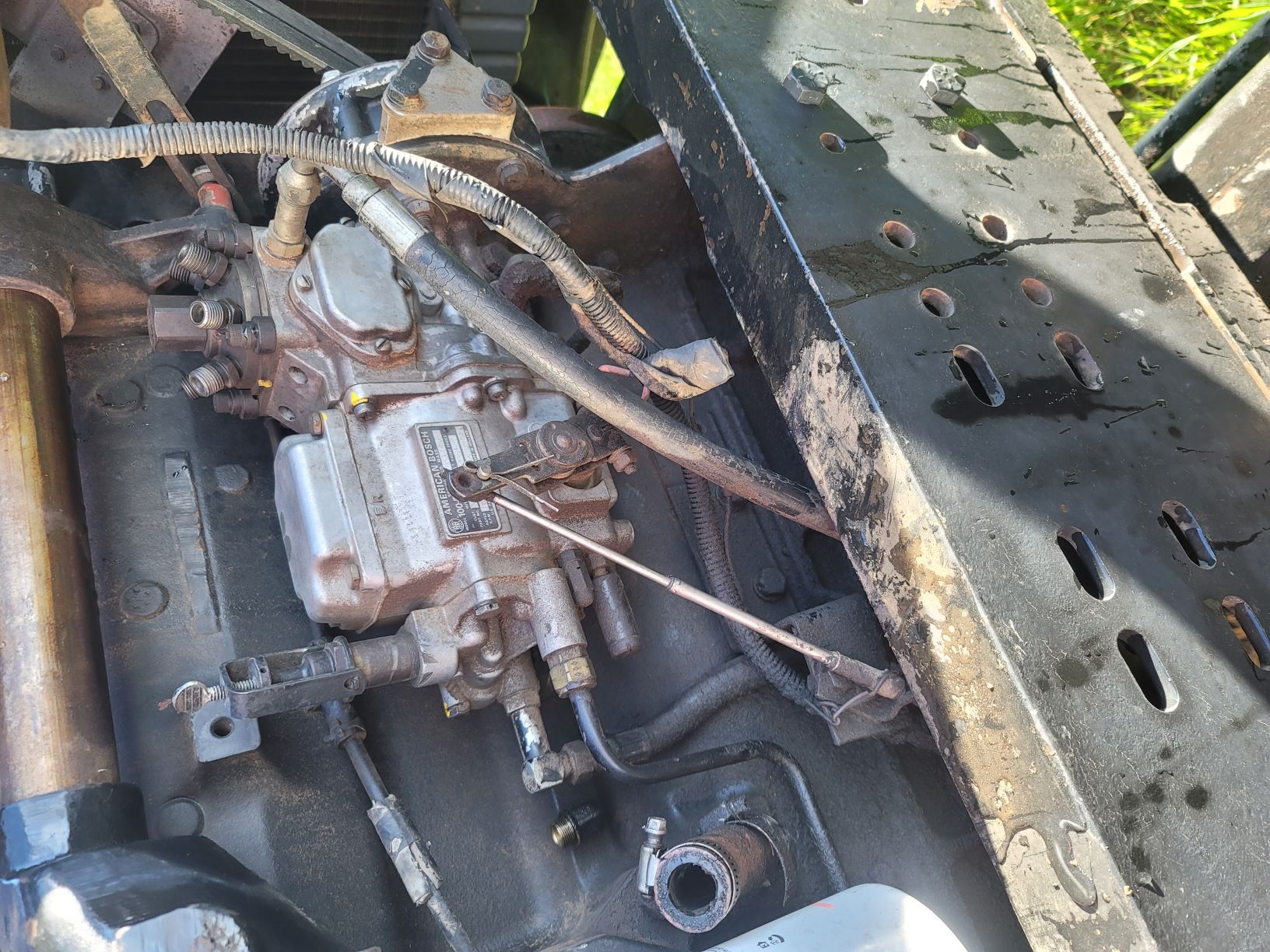

I did put a reman injection pump in it about 5 years ago.  It is the Bosch.  Also had all injectors tested, and it was timed to spec by dealer last time I had issues and had the head off.

Injectors in backwards. Timing advance stuck in retarded on the injection pump. Probably cannot be over-powered at high altitudes for lack of air. 170 PTO HP max.  Those engines weren't that bad, so something hasn't been corrected and your getting the same results.

I M Planning on keeping the Rosa Master pump as I like it better that the touchy Bosch pump if that is what you are talking about?
Posted By: CORLEWFARM
Date Posted: 08 Jun 2021 at 7:34pm
If you keep the rosa you'll won't need to change cover.
Posted By: SteveM C/IL
Date Posted: 08 Jun 2021 at 10:59pm
You can probably use a fuel on/off cable from a 7000 series...you'll have to fab a way to use yor existing throttle cable but it's not a deal breaker

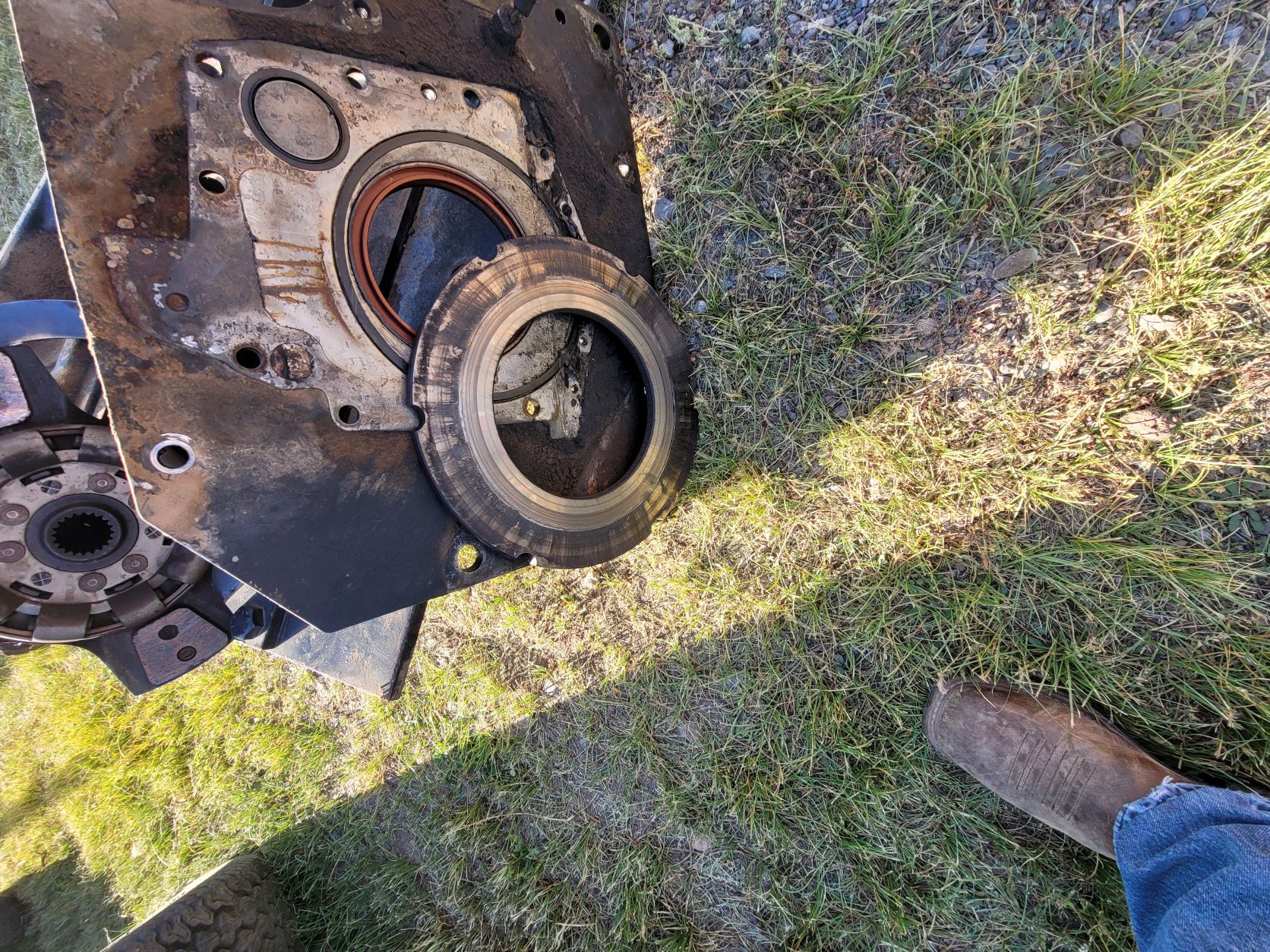

Date Posted: 23 Aug 2021 at 9:16am
I am knee deep now in the swap.  Not terrible but definately learning alot.
Have a question:
Should I have this flywheel resurfaced?  Machine shop is over  a month behind and I was hoping to get this back together before then?  Here ae some picture of it..
THOUGHTS??
Date Posted: 23 Aug 2021 at 12:43pm
I'm no authority. MACK says you replace that pressure plate,not machine it. the flywheel is only thing that gets machinedand it needs done to specs. It's in the service manual.

Date Posted: 24 Aug 2021 at 1:12pm
Thank you so much SteveM. I ordered a new pressure plate!  I am going to see if the local machine shop can resurface the flywheel.  Would you happen to have the specs?  I do not have a service manual.
THanks
Date Posted: 25 Aug 2021 at 10:20am
Need input from Doc or Mack or anyone else who knows but it seems like they shortened the dimensions up a bit for higher hp tractors.
Date Posted: 27 Aug 2021 at 11:25pm
send me a PM with a cell or email and I will send you pic of page in manual on flywheel demensions.
