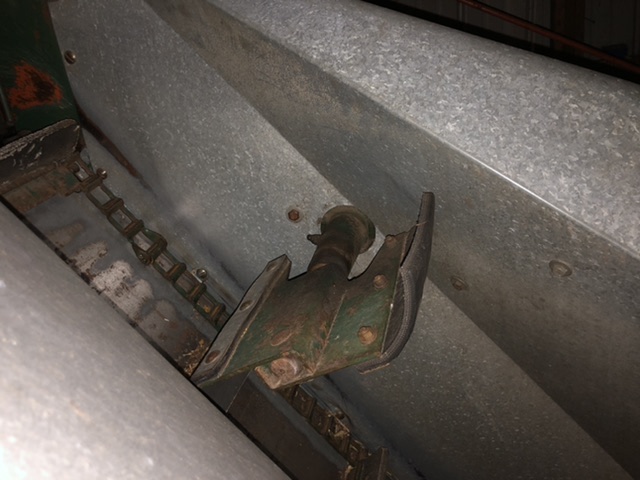

   This is a set of paddles that helps pull out stalks and feeds to trash rollers that get through the snapping rolls and installed in 1st elevator, sold as an option kit. Helps to minimize what trash gets fed though husking bed. I can take a picture when I get out to the farm if you would like. Kevin

This is another picture of the assembly from the outside.

1st one didn’t go for some reason.

Thanks for the pictures. I see it's in there just like the two row. I wonder why I haven't seen these on any one row units before? I wonder what the chances of finding one to add on mine would be?

Well— I know this is the 3rd single row 323 we have had, none had them when the came in. I would go to the scrap yard and look at the 324’s and see if they are the same. We had one years ago, don’t remember what it had? May still be able to purchase new from your dealer?
