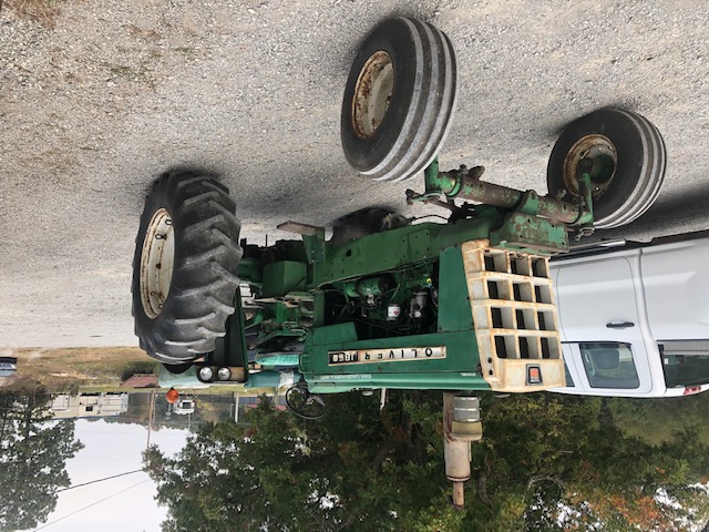

Date Posted: 06 Oct 2020 at 5:08pm
Ended up buying a late 1850 with the over/under. Bought it in PA and they are supposed to deliver it Thursday. We will see how I like it.
Posted By: Lonn
Date Posted: 07 Oct 2020 at 5:53am
I think you'll like it. Some say the 1850 with Perkins diesel was the best Oliver ever offered.
Wink
I am a Russian Bot
Posted By: DrAllis
Date Posted: 07 Oct 2020 at 7:22am
I would agree with that. 1850 was 354 Perkins was pretty darn good. 1855 with Waukeshaw was terrible.
Posted By: Roger (NE)
Date Posted: 07 Oct 2020 at 8:24am
Certainly hope you bought a good one. Out of the eight Oliver tractors we owned through the years the 1850 was by far the worst. Think we had it four years before deciding enough was enough. It spent more time in the dealers shop than at the farm. They never could keep it running correctly. The local fella that bought it called and asked about the problems he was having with it. Yep...same issues we were experiencing. Not sure   where it ended up. Again...hope you got a good one.
Posted By: Gary Burnett
Date Posted: 07 Oct 2020 at 10:01am
If the 1855 has had the updates which by now would be about a 99% chance it did have them it'd be a fine tractor.
Posted By: injpumpEd
Date Posted: 07 Oct 2020 at 10:19am
17/18/1955 are all a better tractor all around, than a 50 series, due to the improved operator station, and closed center hydraulics. The downfall is the Waukesha, but once updated are a great little engine, much like the 301. Capable of way more hp and work than it really should be expected to do lol! The 354 Perkins is a great engine too, and the 2-85 would be the replacement for a 1750/1755 or 1850 at about 85-90hp with the 354, but the 2-105 is turbocharged 354, and is the same operator station as the 17/18/1955. Most of the 105's ran in the field at 120hp. Most of them were running along side 1066/86's and 4430's while being technically a smaller class tractor. Now a 4440 would be different lol!
