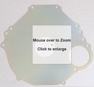

 OK,,I got on a Website,,Ford Power Products.com and according to some of those folks,,what I have is a 1977 Ford 200 out of a Maverick,,,, like ole Steve said earlier.  The pics I took of the engine are same as what they posted. The smaller of the inline 6 's have the integrated intake manifold on the cylinder head, which this one has, also the water pump is 3 bolts Vs the larger engines which have 4 bolt water pumps.  Somebody must of added the belt driven governor on this engine when they decided to use as an industrial application. Gonna remove the governor and prolly save or sell as it is free turning.
 What I need now is a bell housing and a starter for that year maverick or granada. I took the flywheel off and am gonna make me a template for the bell housing bolting to start my scrounging in the wrecking yards,,,,anybody got one in their stash,,,???
Posted By: JC-WI
Date Posted: 18 Aug 2020 at 12:25pm
joe, the block is from a ford maverick, but the yellow is from a different engine bolted on to that block... Head, cover, cleaner, distributor, fan, coil, governor...  go check the Hyster bell housing, maybe it already has the plate on it that you need...  check location of the starter hole too...
  maybe get luck and find the flywheel would fit the FM engine?
Governor is used for constant stead power, I don't know if the forklift would need that or not.
Posted By: chaskaduo
Date Posted: 18 Aug 2020 at 12:28pm
Ebay
$120 shipped
https://www.ebay.com/p/1428047118?iid=124285542589&chn=ps&norover=1&mkevt=1&mkrid=711-117182-37290-0&mkcid=2&itemid=124285542589&targetid=935065066067&device=c&mktype=pla&googleloc=1019973&poi=&campaignid=10460106906&mkgroupid=106723176227&rlsatarget=pla-935065066067&abcId=2146001&merchantid=101829548&gclid=EAIaIQobChMI_LbNgqKl6wIVxcDACh3VPAXdEAYYAiABEgLU7fD_BwE" rel="nofollow - https://www.ebay.com/p/1428047118?iid=124285542589&chn=ps&norover=1&mkevt=1&mkrid=711-117182-37290-0&mkcid=2&itemid=124285542589&targetid=935065066067&device=c&mktype=pla&googleloc=1019973&poi=&campaignid=10460106906&mkgroupid=106723176227&rlsatarget=pla-935065066067&abcId=2146001&merchantid=101829548&gclid=EAIaIQobChMI_LbNgqKl6wIVxcDACh3VPAXdEAYYAiABEgLU7fD_BwE
Posted By: steve(ill)
Date Posted: 18 Aug 2020 at 2:30pm
YEA... in the end if it has to match up to the HYSTER BELL HOUSING, you might as well get it NOW and check out the fit... TOO late later if it wont fit that housing.
It may not be just a simple bell housing since it has to have a hydraulic pump drive, transmission drive, and steering pump drive ???

 Hey JC,,the guy I'm doin the work for told me that this engine is susspossed to bolt up to the Hyster bellhousing,,,,? I was just wanting to get a "something" to mount a starter so I can do whats needed to get this engine running.,,,but you got a dang good idea in that I should go take a real close look and get good measurements on the fork lift assembly first.
 Hey Chask,,good to see you back,,Pardner ,,,hopin your ailmants are gettin under control,,,,ClapClap Yeah,Chask,, I had seen that bell housing on ebay but don't think it would fit as the two upper bolt holes appear to be way too close together than this engine,,,
 You know,,Steve,,I called the dude today and suggested maybe it be cheeper to just take the Hyster engine out and throw a cheep overhaul kit at the Hyster engine and KNOW everything would fit. THing is,,he was told this Ford was in good running shape (when parked) and he already paid for this engine,,,bout 5 months ago,,,,???
Date Posted: 18 Aug 2020 at 10:24pm
well, if you get it running and it dont fit the Hyster, you can always buy a 77 Maverick and GET ER DONE !!Wink
Posted By: Thad in AR.
Date Posted: 19 Aug 2020 at 5:03am
Joe you can start that motor with just that flat plate. I’ve started many that way. Go to the parts store and see what all 2 bolt starters will bolt up the same. You may then find one easier.
I’m using the 300-6 starter on my 351 w.
Posted By: desertjoe
Date Posted: 19 Aug 2020 at 8:35am
  Yeah,,Thad,,that's what I'd really like to do to keep the costs down. I really doubt whatever bell housing I get to match this block is gonna bolt up to the Hyster transmission. I'm gonna go to the parts store this Am see if they have a plate that will bolt to the engine just for mounting the starter,,,,maybe I can float a loan from ole Shameless to buy it,,,,,Wink
Date Posted: 19 Aug 2020 at 10:32am
How's about this one if parts store comes up empty.   $33 + $18 to ship.
https://www.ebay.com/itm/1969-1970-1971-1972-1977-Mustang-Bellhousing-Separator-Block-Plate-157-USA/263854407454?fits=Year%3A1977%7CModel%3AMaverick&epid=2013804747&hash=item3d6ef2bf1e:g:YXkAAOSwpvZaDi8f:sc:FedExHomeDelivery!55436!US!-1" rel="nofollow - https://www.ebay.com/itm/1969-1970-1971-1972-1977-Mustang-Bellhousing-Separator-Block-Plate-157-USA/263854407454?fits=Year%3A1977%7CModel%3AMaverick&epid=2013804747&hash=item3d6ef2bf1e:g:YXkAAOSwpvZaDi8f:sc:FedExHomeDelivery!55436!US!-1
Posted By: Ray54
Date Posted: 19 Aug 2020 at 1:52pm
Wink Back at the beginning of this ......Confused, adventure I was thinking Joe ant that big a sucker. But buying pieces just to start this little mechanical wonder...............Confused,maybe O'l Joe can be suckered. When the deep pockets guy LOL thinks this just needs a few bolts moved around,O'l Joe may have to shenanigan Deep Pockets into paying for extras.
I am guessing that the fork truck is still moving so you cannot just get the old bell housing to see for 100% that things fit? Since your in this far I guess you can tell him he needs a new starter for a new engine.LOL
As good as you are Joe, Wink to fix all this junk with other free junk I need to get you working all my treasures.LOLLOLLOL
Posted By: JC-WI
Date Posted: 09 Sep 2020 at 10:56am
DJ wrote in a different thread he started.... just hooking his new post to his old link.
Well,,I had commented on wantin to help a friend out with his forklift but couldn't find the dang thread,,,so,,,here I go again.
 A good friend has an older  Hyster Model RT100 forklift that he was using to move some old cars and trks around on his yard and the engine finally crapped out. I had done a southern engineerin job on the carburator as it was messing up and we could not locate a kit for it so I made an "adapter" from the Hyster manifold to a Carter I had laying around and it worked great till the engine crapped a couple of weeks ago. The engine in forklift is a 6 cylinder gas Silver Diamond Model GRD214.
 Then he bought what they told him was an Industrial Ford 6 cylinder that would bolt up to the Hyster bellhousing,,SOO I tool that engine home and was gonna get it tuned up and running for him to stick in the forklift. Flash forward,,the engine is out of a dang Ford Pinto or some such and it was locked up and after 2 weeks of the Acetone/Atf,treatment ,it finally broke loose but it has ZERO compression,,,rings prolly stuck really good and since it is NOT an industrial ,,it will not even bolt up to the hyster bellhousing. I convinced him to either overhaul the Hyster engine or find a used replacement somewhere.
 Does anybody here know if any other engines will interchange since the Hyster's are almost non-existing,,,? Prolly parts for his are gonna be even harder to find as well,,,,,,
