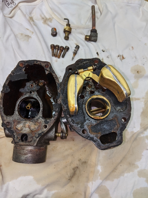

Posted By: Hunt4Allis
Date Posted: 24 Mar 2020 at 8:20am
I'm really hoping it's a issue with carb and not the gov or something else, but it seams like it should be b/c all this issue started after I filled tank completely and drove 200 yrds.before that tractor had no issue with running although now that I'm thinking back when I initially test drove it it was sputtering under load of a hill at owners place where I bought itπŸ™„.but this is completely different in the fact that now I found the orifices blocked completely by a ladybug and spiders( got that taken care of last weekend) and even after all that cleaned out including the tank itself it would only stay idling when I pushed the choke lever every 10 seconds or so and if I let it go more than that it stalled...

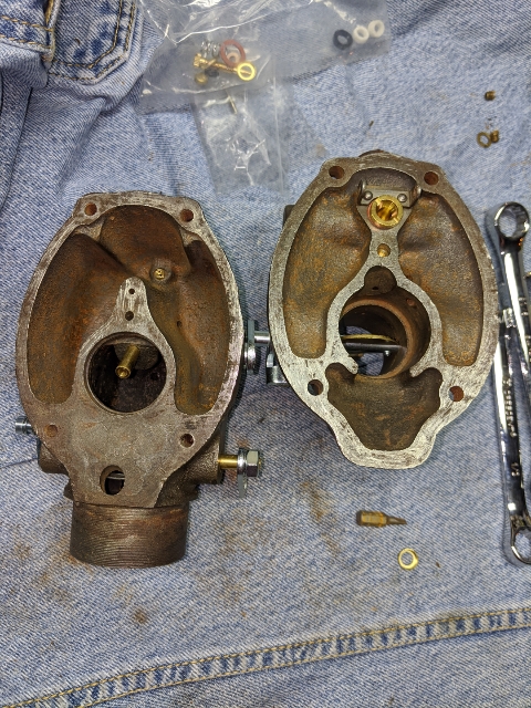

Posted By: CTuckerNWIL
Date Posted: 25 Mar 2020 at 8:41am
Originally posted by Hunt4Allis Hunt4Allis wrote:
here's 2 pictures of my carb off d17.
 If you are using a rubber gas line between the sediment bowl and the carb, that may be adding to your problems. They can look fine on the outside, but start breaking down internally and fill little holes in the jets with pieces of rotted rubber.
 I know it's the easy way, with rubber hose, but the original steel lines worked fine for decades and are still the best way to go IMO.
 I had the neighbors 770 Oliver here some years ago and it would run fine for maybe a couple minutes, maybe 5 or more, then die like you shut the key off. I kept thinking the coil or condenser was bad. Come to find out, there were about a dozen of those stinking 'Asian' lady bugs in the tank. They must be able to skinny in thru the gas cap somehow,, when looking for a winter home.
Date Posted: 25 Mar 2020 at 11:20am
Just cleaning the years of gunk off the outside, inside and rebuild to come.
Posted By: FREEDGUY
Date Posted: 25 Mar 2020 at 6:03pm
Just out of curiosity, if  the exterior of your 'carb looks like that, what does the rest of the block look like Geek ? That thing is a disaster externally IMO.
Date Posted: 25 Mar 2020 at 6:42pm
It's no show tractor, definitely has work clothes on😁
It does look rough, but at least there's not a quarter to a half-inch of gunk covering the whole thing anymore.
It makes me laugh because it's kind of like other guys at work that have 60 to $80,000 trucks that never even used the four-wheel drive or tow anything or even put mulch in the bed (a waste, imo)
I'm more concerned with how well it operates not looking for a showpiece that never leaves the concrete floor of someone's shop...
Thanks Matt πŸ‘
Posted By: FREEDGUY
Date Posted: 25 Mar 2020 at 6:48pm
Just saying that if the carb is that oily on the outside of "it", maybe you've got some leaking seals/ gaskets elsewhere that might make a carb rebuild "moot"?
No I am not sure what you are talking about with the screw to get to the bowl?
 Some TSX carbs have the power metering screw come in from the top half and are long and extend into the bottom half.
 This carb has the power metering screw in the bottom 'front' side of the bowl and does not interfere with splitting the halves.
 Here is a Marv Schebler PDF file that may come in handy.
http://fergusontractors.org/nfs/wp-content/uploads/technical-articles/Carburetor-Information.pdf" rel="nofollow - http://fergusontractors.org/nfs/wp-content/uploads/technical-articles/Carburetor-Information.pdf
Date Posted: 27 Mar 2020 at 7:43am
  Been a long time since had mine apart but I thought it had the tube behind that external power screw...like a Briggs &Stratton.
 It does have a 'tube' behind the 'external power screw' but that screw is on the bottom front of the bowl, not the top, and doesn't interfere with splitting the carb in half.
 If the power adjust needle is on top, the needle goes way down into the bottom and has to be removed to split it.

Ok,
I have a question about one of the floats in my carburetor was bent when I disassembled it (not the arms that hold the floats but the actual float is bent in, in other words it does not look the same as the other side and I'm wondering how do I check the floats to make sure they're not damaged or allowing gas to get inside of them?
Date Posted: 28 Mar 2020 at 7:36am
Before and after
Got her all cleaned up/ rebuilt with new carb kit and ready to hook back up and give it a go🀞
There were a lot of the small ports that were closed off completely and a lot of junk pretty much everywhere inside of the carb, I don't think it's ever been cleaned since manufactured in 1959 so it always feels good to do your best at getting something back to decent condition.
Posted By: Sugarmaker
Date Posted: 28 Mar 2020 at 7:58am
Matt,
 That is looking a lot better! Hope the D17 runs better for you too! Thanks for the updates on the carb rebuild.
