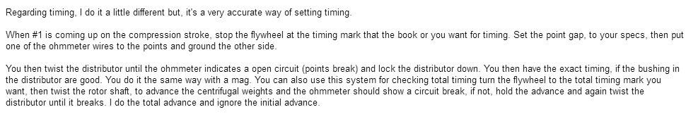

Posted By: ac fleet
Date Posted: 19 Jul 2019 at 9:48am
Not sure about your description, BUT it sounds like the dist. is advanced to far. Try setting it WITH engine running. ---- as you move it back and forth, pick the best sounding spot and snug down the clamp bolt and try that.---may take a few tries to get it fine tuned but they are picky on the set. ---I have one that I never could get smooth, close but still a bit choppy. thanks; ac fleet

Posted By: Buckyman
Date Posted: 20 Jul 2019 at 7:58pm
Thank you very much ac fleet! All I had to do was loosen the clamps(on the distributor) and make almost a quarter turn clockwise and now it runs like a top!
