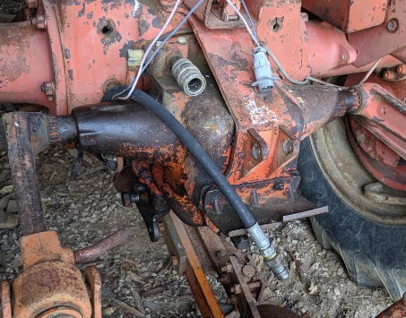

Posted By: DrAllis
Date Posted: 12 Jul 2019 at 7:05am
In my mind there are FIVE series of the D-17 tractor. The wider drawbar bail and full-flow oil may very well be what some would call S-1, but it was two very important changes from the first batch of tractors. And then there was the belt driven power steering pump that happened before the S-3 models.

Posted By: DrAllis
Date Posted: 12 Jul 2019 at 7:15am
I know I've seen some with the belt driven PS pump, but according to AGCOPARTSBOOKS it began at 42001 and up (S-3), so what I have seen must have been changed over or didn't have PS when new and got a PS kit field installed.

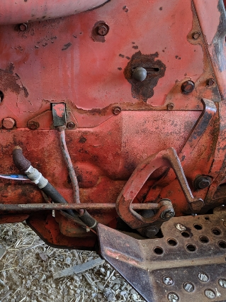

Posted By: Hunt4Allis
Date Posted: 23 Jul 2019 at 10:47pm
Okay I don't think mine has power steering although with it being a wide front end it steers pretty easily...
Posted By: dt1050
Date Posted: 24 Jul 2019 at 5:08am
power steering is nice with a loader mine has a 7.5ft bucket.  you couldn't steer it with out power steering...lol.   but aside from the power director popping out of gear i don't think there are any real issues with these machines and  unlike the older machines the engine should hold you back when going down hill a real plus on a hillside like mine. lol

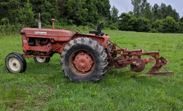

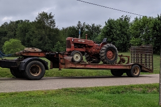

Date Posted: 01 Aug 2019 at 12:11am
Just got this delivered yesterday!
I can now hopefully do some of my own farm fields by myself without having to rely on anyone else to plow or cut my fields( my collection is now my dad's 1950 AC-b, 1953 AC-ca, and last edition a 1959 AC- d-17)
Now it's just a matter of finding the time to put em to work( which I've already started to use my CA this year finally for BH work, post hole work, and possibly run my 80t sickle mower for a second cutting hay for our beef cows
Posted By: frnkeore
Date Posted: 01 Aug 2019 at 12:38am
Overall, it looks very nice. Did you get a blade with it, too?

Yes,7'snap coupler rear blade, 3 bottom plow from a WD converted to a snap coupler, snap coupler tow bar.
I know the previous owner used the rear blade but the 3 bottom plow is a bit rusted solid at the hand crank for height adjustment so it's untested...

 The 17 will be your work horse for sure! Start soaking that adjuster on the plow, then later some heat to loosen the rust. Tractor looks good! Have fun with your new toy!  Your collection is growing! You need to add a WD45 in there too!

I'd get a set of "snap coupler" lift arms for the plow before you use it!
Ok, why?
Right now it's hooked up with what I would call a " ball & socket type of hook up ( I removed the snap coupler grips off of the lift arms and slid what was already mounted on the plow over these arms, which have a screw to tighten down onto the arms- I believe that this 3 bottom plow was paired with a 45 the guy also had for sale)
Thanks Matt
Ok, why?
Thanks Matt
I would have to do a little more research but I believe the SC type implements should have the SC type lift latches for safety. If the bottom SC joint would ever open and or release the plows would push up on the SC latches and release the plow from the tractor.
Having it fastened tight might allow the plows to pivot around that point and end up on top of the driver. Now I am not in any way a expert on these, but I believe that is the design intent of the Allis SC (snap coupler) design. I believe you said your plows have been converted from a pin hitch to a SC. So that may have been the system used on the WD prior to the SC system. Hope others will chime in.
I really like your 17! Mine is still in its work cloths and the wife said it really doesn't look good with these other painted tractors! Maybe a hint of another project in the works??

This is why you don't use pins to attach to the lift arms, with a snap couple plow.
Use the proper lift latches, unless you have a real hard head.
http://i1213.photobucket.com/albums/cc473/SmbdyElz/Plow/PlowOOPS_zps4fea78d4.jpg

Thanks Charley for posting the pic, I looked for this one and gave up. Yes is might happen with your plow setup. PLEASE change it!!!!!
Posted By: IBWD MIke
Date Posted: 05 Aug 2019 at 8:56am
Another thing that contributes to this but doesn't get talked about too much is the wear in the snap-coupler system. If you step on the drawbar and it goes down several inchs, that's not good. The edges of the snap coupler 'bell' and the support it is pinned to wear over time, my opinion, the sloppier the more likely it is to uncouple. The spring in there is another consideration, if you're in there, replace it. They are not that expensive.
Using an implement that is snap-couple with pin-hitch lift links is a serious No-No. I'm sure a lot of farmers did it for years and got by. That pic  CTucker posted is good evidence not to do it.

I'm wondering why I have what seems like a supply and return line on my d-17 in these two pictures it shows the rear and then the side of the tractor where the lines go into? anyone seen this before or is this how all of them are?

Date Posted: 21 Aug 2019 at 8:37pm
They all have them. They original were both steel. Your rubber hose is a replacement

Date Posted: 21 Aug 2019 at 9:00pm
Ok, but a d17 is a power raise only correct with no hydraulic power down?
Posted By: frnkeore
Date Posted: 22 Aug 2019 at 1:47am
Those lines are for a hydraulic cylinder on the implement.
Quick couple is pressure and the rubber is the return line.

So this system of pressure and return line is what benefit compared to let's say my CA with only a pressure line?
Posted By: DrAllis
Date Posted: 22 Aug 2019 at 7:06am
Someone has added that to the tractor so that they could connect a two-way cylinder and have a breather for the second hose thru the tractors hydraulic sump. No advantage over the D-14, except you can use a two-way ram with no modifications.
