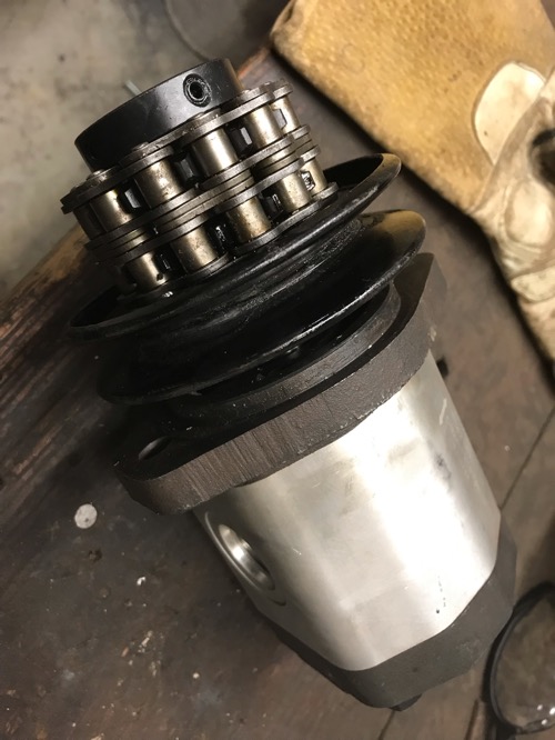

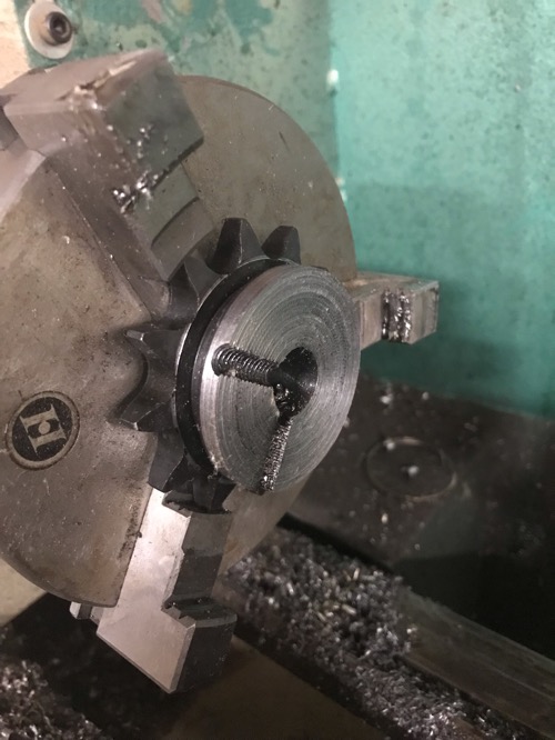

Posted By: nickia
Date Posted: 10 Jan 2019 at 8:14pm
where did you find your front pump shaft and coupler that bolts to your front crank pulley?
Posted By: 7060
Date Posted: 10 Jan 2019 at 11:58pm
For the air conditioning I am using an aftermarket underdash ac unit. On the pump setup I went to the local driveline shop looking for a coupler and shaft to make my own crank pulley hub, and he looked in a book and found a hub and 13” shaft that fit.

Date Posted: 11 Jan 2019 at 8:41pm
A-C had an optional front "auxiliary" hydraulic pump that sat inside of the sheet metal. I've only seen pictures of it, but it appears the driveshaft was a 2-wire hydraulic hose of some sort. No Love-Joy coupler on the pump shaft and the pump bolted directly to the holes in the front support. AGCOPARTSBOOKS.com page 238 shows the pump and page 268 shows the driveshaft under D-19 tractor info.

Posted By: Jess
Date Posted: 11 Jan 2019 at 9:49pm
Looks good  when i did mine the love joy did not stand up to hard hyd use so i used a chain coupler on the pump drive for next 4 tractors that i did     not sure what you are planning on for hyd valves but i found 180 or 185 had good valves that are small and compact and stackable i put 3 spools on all mine

Posted By: bradley6874
Date Posted: 12 Jan 2019 at 9:44pm
For the love joy to hold up it needs a bearing in the adapter bracket with the rubber mounts and such a long shaft without ballincing it the swing will beat the rubber out also move the belt for your alt back the shaft side that takes the extra load off the coupler and side pull on a pump isn't good
Posted By: nickia
Date Posted: 12 Jan 2019 at 9:50pm
thank you it looks like a better set up than whats on my i615 I had to weld the shaft to the pulley adapter plate didn't weld strait so I have a wobble and a engine that shakes the other end is a dubble roller chain coupler I would like to redo with a love joy I think I would take out the wobble
Posted By: 7060
Date Posted: 12 Jan 2019 at 9:54pm
The alt doesn’t need much belt tension and I’ve seen those pumps belt driven before so I didn’t think the side load would be an issue. I don’t really have the room to move the alternator back or it will get into the radiator, but I could add a bearing. It will only cost my a coupler, pulley, and a little time though so I may go back to the chain coupler. The idler bearings I used two new ball bearings that I had, actually for the trap slides on a Timpte grain trailer.

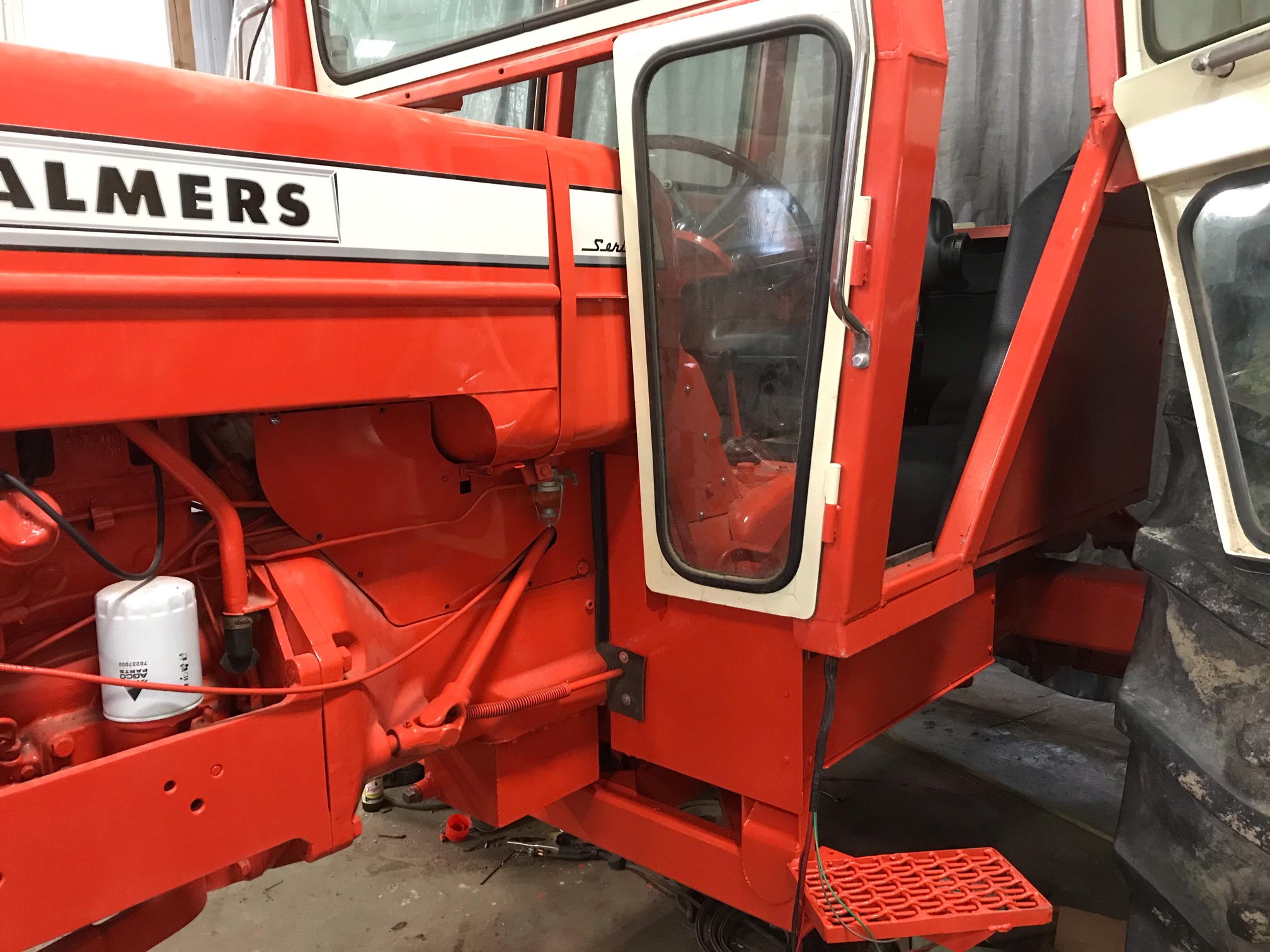

Posted By: 7060

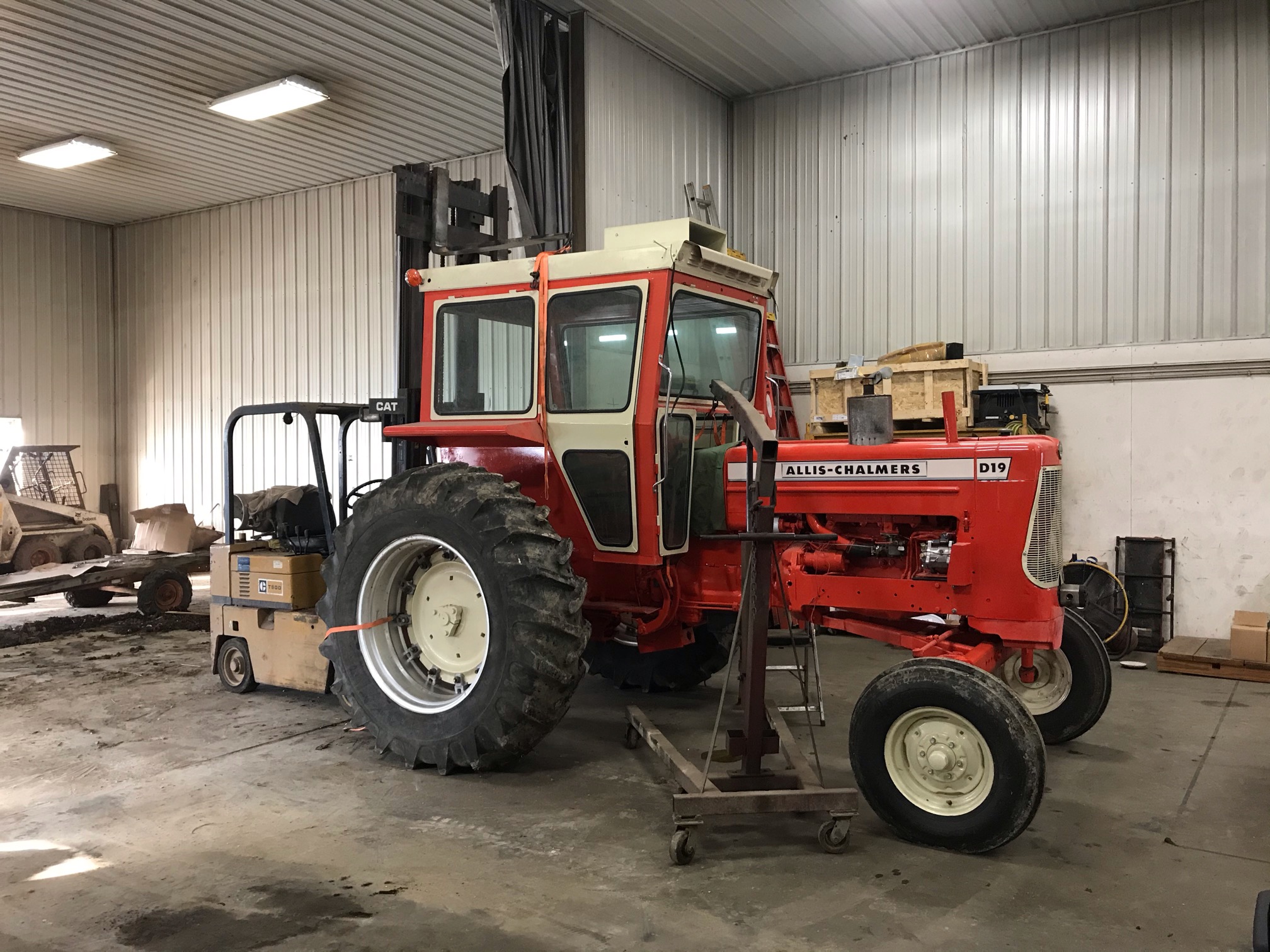

Date Posted: 25 Jan 2020 at 11:56am
Posted By: 7060
Date Posted: 25 Jan 2020 at 11:57am
Decided not to go with the loader. Been working on trying to finish it up this last week. Ready to work on hydraulic plumbing now and air conditioning hoses now.

Date Posted: 25 Jan 2020 at 5:40pm
7060,
The D19 sure looks good with a cab! You have done a incredible job getting this to fit and look right. Nice upgrades too. Hope it works as good as it looks!

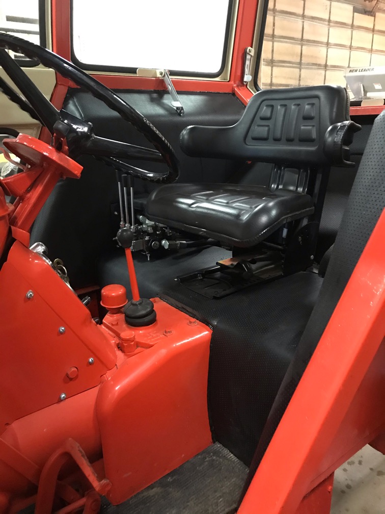

Posted By: DanWi
Date Posted: 25 Jan 2020 at 9:23pm

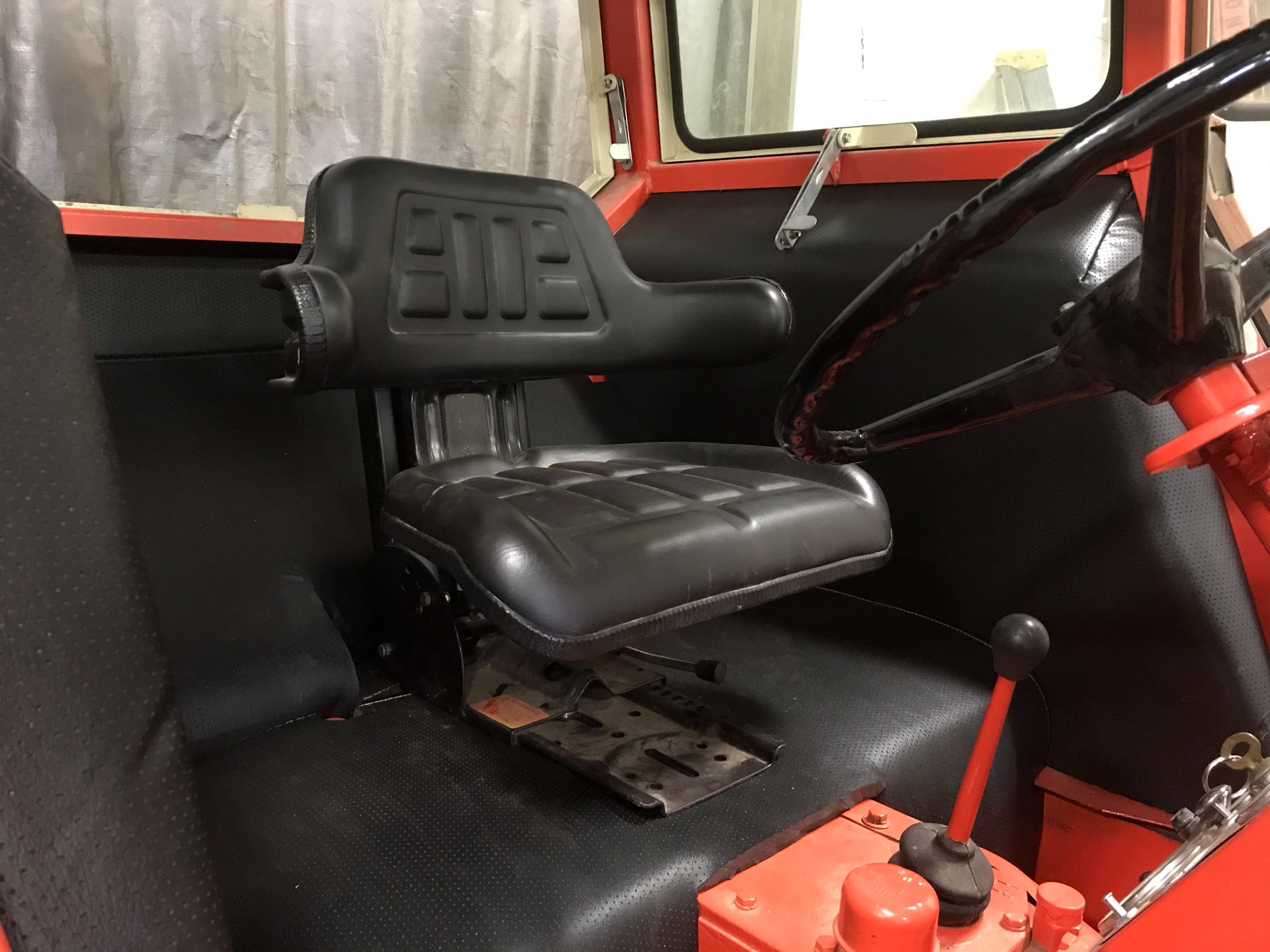

What did you do with the hydraulics beside the seat?
Posted By: 7060
Date Posted: 26 Jan 2020 at 12:11am
I gutted the old hydraulic pump, and valves. I added a bigger sump to give it about 2.5 gallons more capacity. I have a new 3 spool double acting valve to go on the right side of the seat. One valve for 3point and the other 2 for remotes, powered by the front mounted pump.

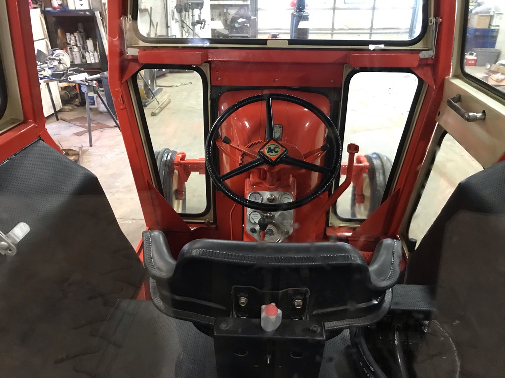

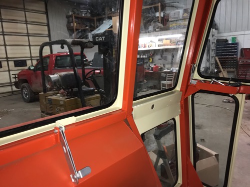

Posted By: 7060
Date Posted: 16 Feb 2020 at 9:59am

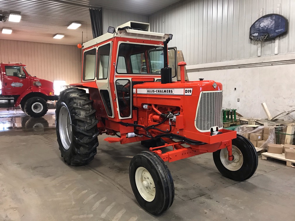

Other than my right door handle and latch on order it is finally finished and ready to move on to the next one. Hopefully I got this picture thing figured out this time. I’m looking for a set of stack weights for the front if anyone has some they would want to bring to the swap meet in Missouri.
Date Posted: 16 Feb 2020 at 10:10am
7060,
 It just looks right with the cab on the D19! You sure did a nice job on all the details too.
Thanks for the updates! and the nice pictures!

Posted By: Dave(inMA)
Date Posted: 16 Feb 2020 at 12:18pm
Looks as though you've got the picture thing figured out just fine! And what a nice looking D19!!
WC, CA, D14, WD45
Posted By: MDWilliams338
Date Posted: 16 Feb 2020 at 2:10pm
That would’ve been a killer production tractor...absolutely a nice job!!!!!!👍
Posted By: 45 turboa-
Date Posted: 16 Feb 2020 at 2:26pm
Looks great !!
turbocharged
Posted By: Reindeer
Date Posted: 16 Feb 2020 at 8:18pm
Lots of attention to detail! Very nice!

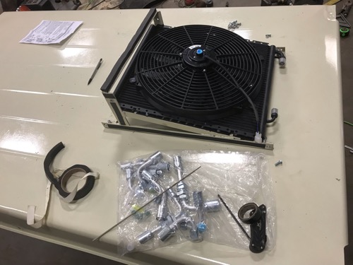

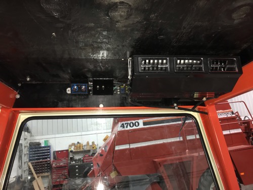

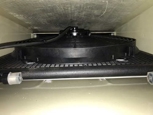

Posted By: Mikez
Date Posted: 16 Feb 2020 at 8:46pm
Wow it sure does look nice. I'd be interested in how your AC works
Posted By: 7060
Date Posted: 16 Feb 2020 at 9:24pm
I charged it in the 70 degree shop and it blows ice cold, but time will tell once summer comes. My biggest concern was the evaporator unit doesn’t use a filter. The condenser fan I used was meant for a cooling fan on a vehicle radiator and moves a lot of air.
