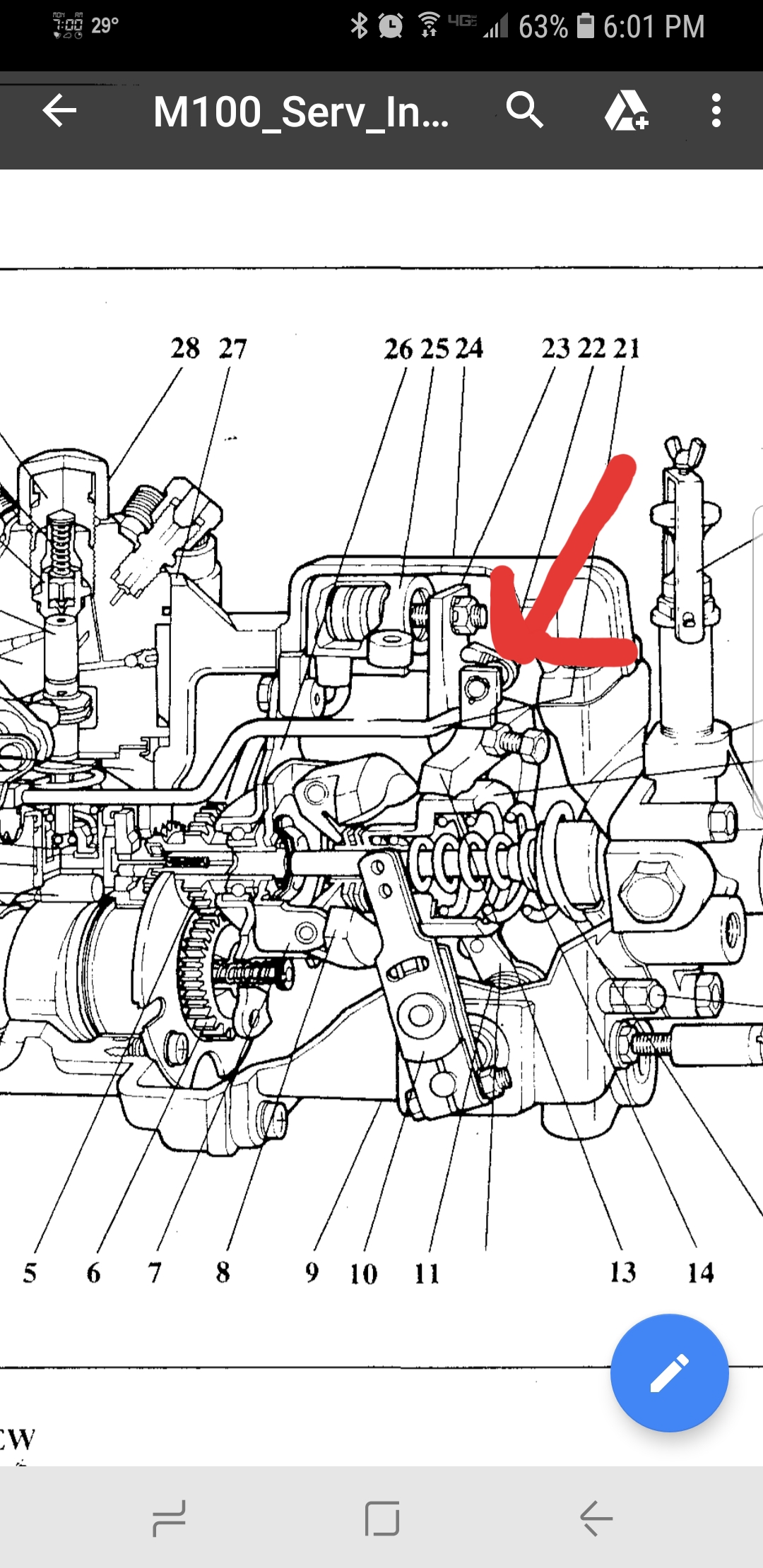

sWhich spring are you guys talking about to help the flutter? Our 8030 has had the pump sent off to fix a flutter issue. Got it back and it was good for 20 hours maybe and its back to doing the same thing. Tractor has good power, starts great, just has a real bad flutter when not under a hard pull.

Had this same trouble with our couple 8000 series. Have you ever replaced the fuel hose that goes from the fuel filter to the head of the pump? Not the hoses on the back of the pump, the one that goes to the front of the pump on the side.
ACFarmer wrote:
sWhich spring are you guys talking about to help the flutter? Our 8030 has had the pump sent off to fix a flutter issue. Got it back and it was good for 20 hours maybe and its back to doing the same thing. Tractor has good power, starts great, just has a real bad flutter when not under a hard pull. |

If you take the top cover of the pump with the 4 bolts there is the fulcrum lever that attaches to the governor lever. It's kinda hard to explain without a picture but there is a nut next you where the governor arm attaches that is towards the outside of the pump housing. There is a spring between the governor arm and the nut. I've had to tighten this nut periodically to keep the flutter out. From what I've been told there are different governor springs that are down in the pump that are supposed to cure this problem. I guess it is more of a problem in the powershift tractors.

Posted By: HagerAC
Date Posted: 07 Nov 2018 at 6:08pm
ACFarmer here's a pic of the pump schematic. The nut is located where the arrow is pointing. There is a nut on the opposite side holding a cam looking piece. Don't do anything with that nut, just tighten the one next to the governor arm. Tighten it enough to take care of the flutter but make sure the fulcrum lever still moves freely. If it's too tight it'll really make the governor lazy. This schematic must be from a pump used on an IH because everything is on the opposite side of the ones used on the ac's. I've changed the fuel line on mine but it did not cure the flutter in mine. Hope this helps
------------- 30+ A-Cs ranging from a 1928 20-35, to a 1984 8070FWA, Gleaner R52
Posted By: ACFarmer
Date Posted: 07 Nov 2018 at 7:17pm
Thanks. Gives me an idea on where to head with it. The flutter makes it annoying to run. And it is a powershift as well.

Posted By: HagerAC
Date Posted: 07 Nov 2018 at 8:44pm
Yes I know how you feel. I had another forum member inform me on it and he actually came to our farm and helped me with mine. We tried to loctite the nut in place that time but it never held. Being its been too wet to do much here the last few days I took the time and tried to loctite it again. Hoping it will hold this time.

Posted By: DrAllis
Date Posted: 08 Nov 2018 at 7:11am
Takes a 7/16" wrench if I remember right.
Posted By: HagerAC
Date Posted: 08 Nov 2018 at 7:20am
7/16 probably works. Its actually an 11 mm. Same size as the bolts for the top cover

HagerAC wrote:
7/16 probably works. Its actually an 11 mm. Same size as the bolts for the top cover |
Actually, it is 7/16", those are American Bosch pumps, and all fasteners are standard, most are 1/4" coarse, some 1/4" fine.
