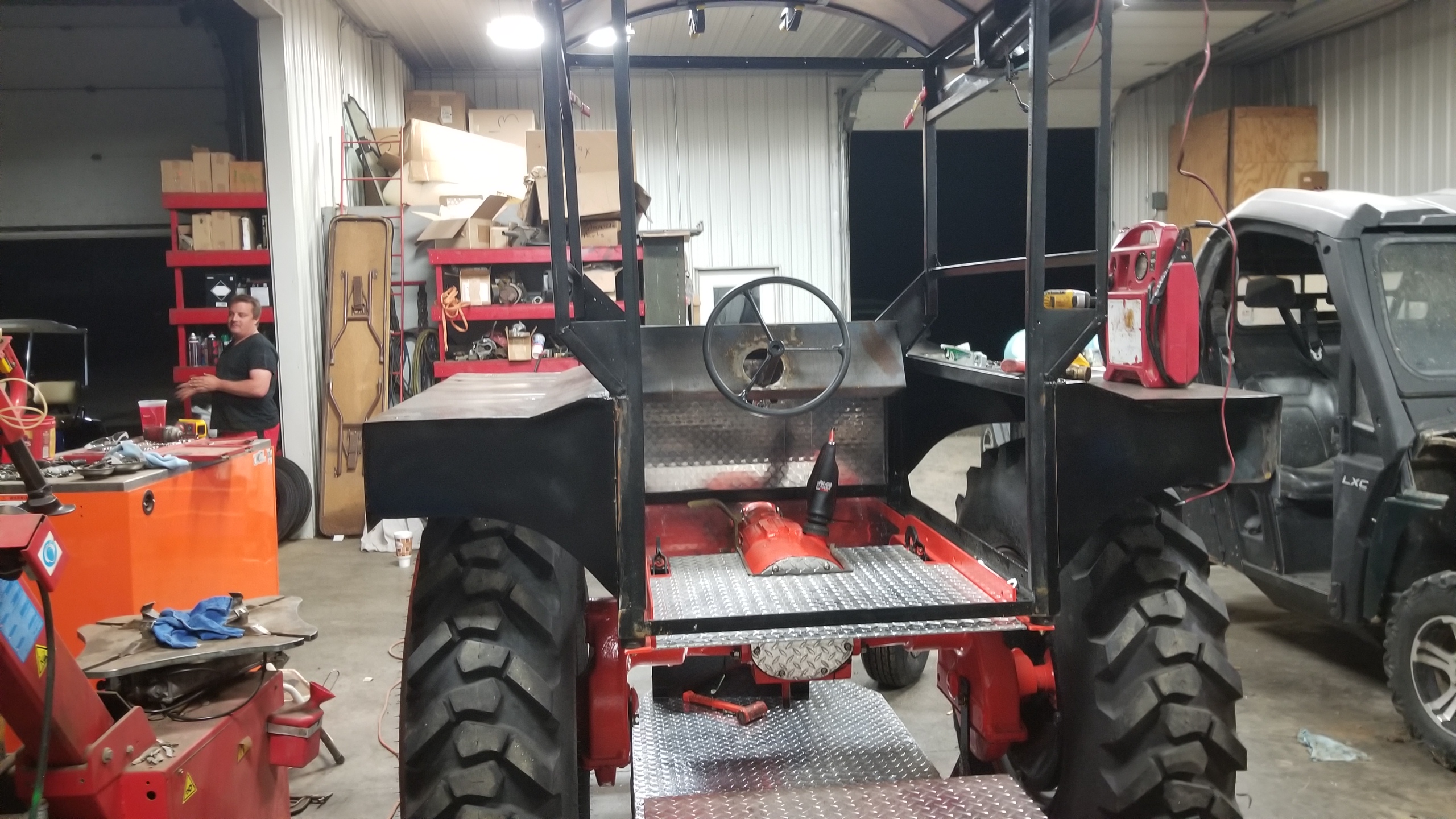

Date Posted: 12 Sep 2018 at 5:40am
I put a quickster gearbox on my steering shaft to slow down the steering. Make it 4.5 lock to lock compared to 2.25 .hillbilly power steering and a little easier to drive down the road
Posted By: Super B
Date Posted: 12 Sep 2018 at 5:43am
Got the ca trans in it too

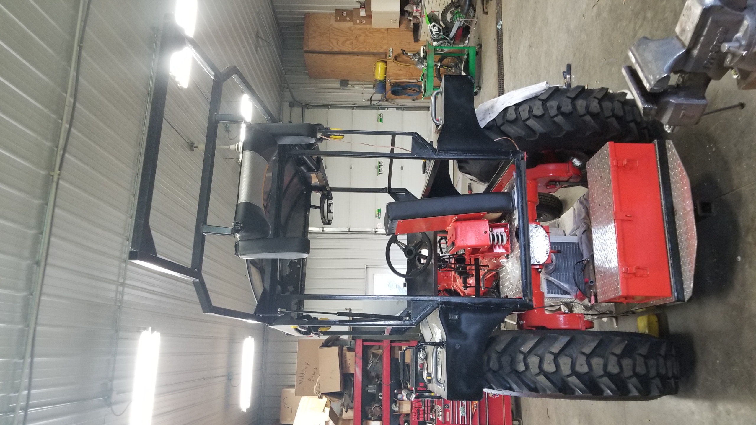

Got the hood made for the super b xt
Posted By: Dick L
Date Posted: 23 Sep 2018 at 9:16am
That is going to be a head turner for sure when done.
