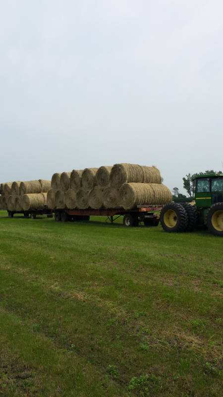

Posted By: Tbone95
Date Posted: 22 Jun 2018 at 10:11am
Sorry about the poor pictures guys.  Like the hay hook in the view here, lol.  Was in motion and very bright out and I didn't see it.  So that's my daughter driving.  Deere 2555, NH 273 baler.  Too cold to bale at like 69F  Was 97 on Sunday, shoulda started then!!!
So this is what the overhang typically looks like, not 30% like I said, more like 15%, helps make a nice wide base, and the side boards dish it upwards ever so slightly.
The finished product.  This is the field where I learned that a rolling harrow, even with a  buster bar, does NOT fill in uneven areas from plowing and discing! LOL  So the back of field is rough to begin with, and then last years was so wet made ruts round baling.  So this load is only 5 high, and only 4 bales on the 4th tier.  With good heavy bales and a little smoother ride, I often put 5 on there, no problem.  And same goes for 6th tier, would be 3 up there, but this load is getting backed into a shed that 6 won't fit under, waiting for a customer, so no point in putting them up there just to take 'em off and haul them home.
Same load.  The brown short crappy looking ones on the lower left of the pic are the ones left in the baler from last year.  There are 109 bales on the wagon.
My daughter in front of the barn my Grandpa built.  Not sure how much longer the ol' barn will be with usCry  This is a nice 6 tier load, 115 on this one.
Typical photo of round baler inaction.  That's not a typo, space left out on purposeAngryAngryAngryFriggin' contraption anyhow!!!
Sorry, not the best of pics, but thanks for looking.
Posted By: Red Bank
Date Posted: 22 Jun 2018 at 2:31pm
Thanks for posting the pictures. Love that barn and I am always jealous of flat hay fields. Riding my hay wagon is like a rollercoaster.
