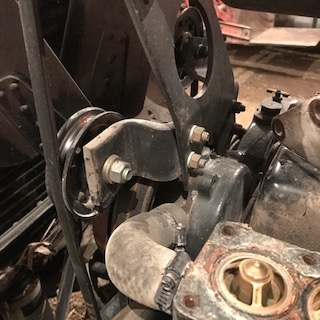

Posted By: Hurst
Date Posted: 16 Jun 2018 at 8:40pm
Here is what the pulley looks like.  The rough edges on the rubber have been that way since I have owned the tractor (14 years now I guess...).  Now signs of it shifting back or forward.  Double belt for fan/alternator appears to have good pulley alignment.
1979 Allis Chalmers 7000
5800 Hours
Posted By: Red Bank
Date Posted: 16 Jun 2018 at 8:50pm
Yours looks fine so I don't think that's the problem. I was just offering the advice because it just happened to me. The compressor mounts and bolts are all ok? And will it throw the belt without having the A/C on?

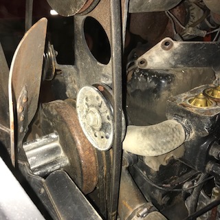

Posted By: farmboy520
Date Posted: 28 Jun 2018 at 8:10am
Sorry for taking so long
Posted By: Hurst
Date Posted: 28 Jun 2018 at 12:07pm
No worries, I appreciate the picture.  It looks like the 7020 has a little different accessory belt path than the 7000, but the A/C is the same.  My alternator is on the tractor's left side.  I will hang onto this photo in case it comes down to adding another pulley.  Oddly, the side that whips the most is the side with the tensioner on it.  The worst part is between the crank pulley and the tensioner.  I'm contemplating a new compressor since it feels like it is only compressing about 1/2 of the rotation, whereas an axial compressor, it should feel like a pretty consistent torque all the way around.
