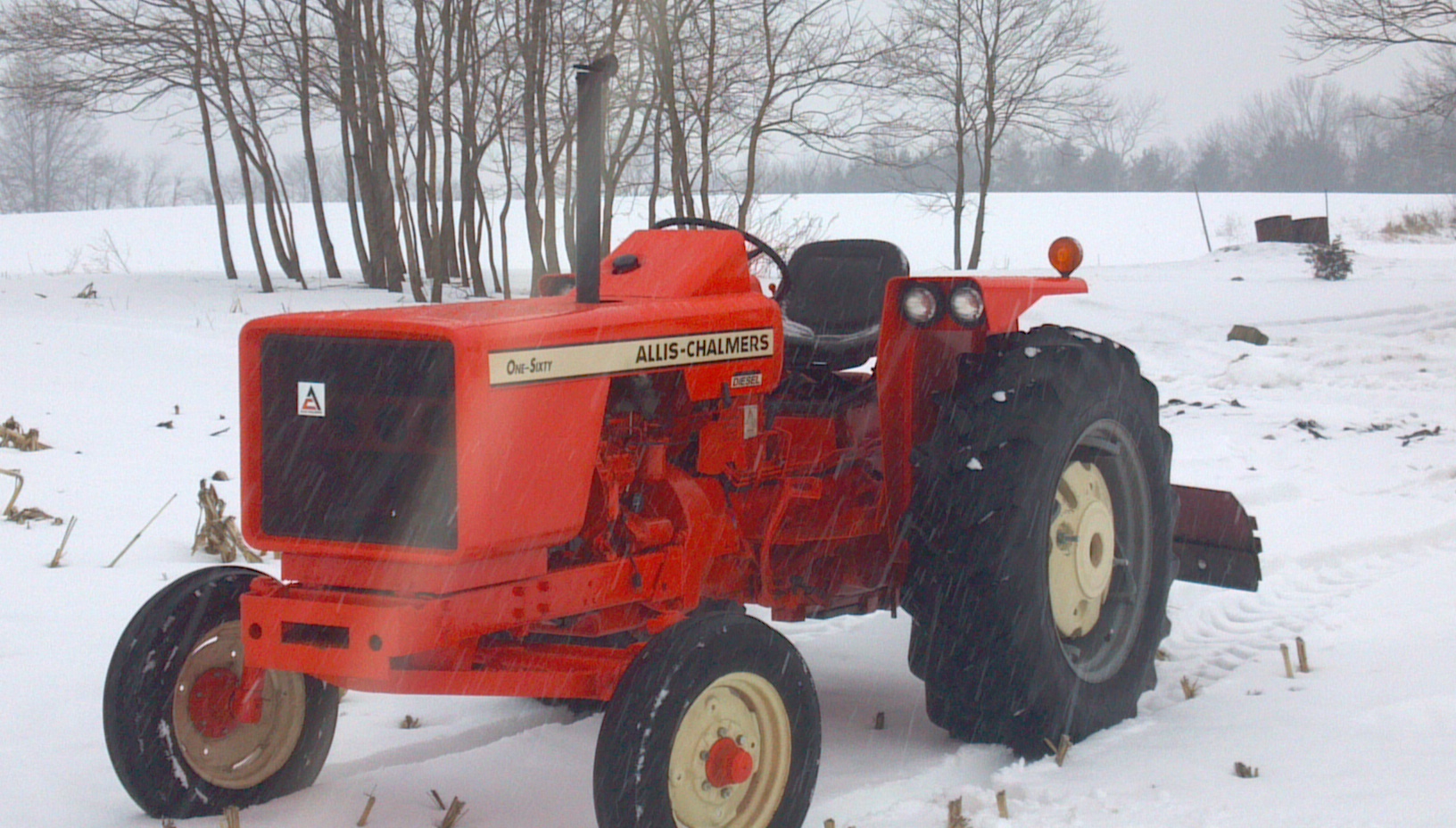

My uncle bought this tractor new in 1970 and I learned how to drive on it at the ripe old age of 5.  One of my earliest childhood memories is riding around sitting on the tool box bolted to the left fender.  I was 3 or 4 years old at the time.
When my uncle passed away, I hauled it back from West Virginia and parked it in my garage.  I'm starting the restoration and am still in the process of taking it apart.  Photos follow:
Shortly after coming off the farm:
Cleaning and disassembly progress:
Another day or two spent tearing it apart and it will be time to start cleaning and reassembling.
Fair Warning: I'm planning to do a thing or two that will likely upset the Correctness Police.
An optimist sees the glass as half full. The pessimist sees the glass as half empty. The engineer sees a glass with double the required capacity.

Frame rails and front wheels back in place.  I'm happy to have it back on four wheels.
Still a long ways to go but it feels good to finally get the engine and frame back in place.

Posted By: Flyer
Date Posted: 19 Feb 2018 at 11:01am
I just hope the engine is as reliable post-rebuild as it was before.  I made the right call on the rebuild considering what I found on the inside of the fuel tank and what the people rebuilding the injection pump found when they opened it up.  However, I'm not going to have it far enough together to fire up until well after it's painted and I really don't want to have to tear into it at that point.

Posted By: Flyer
Date Posted: 18 Apr 2018 at 8:46am
Spent several weeks cleaning parts, getting organized, and waiting for weather to support a final power wash and sand blast.  We had two nice days last week and managed to get it blasted and in the paint booth.  It snowed while it was in the booth and cleared off enough to get it back out last night.  We were in a bit of a rush to get it moved back to the shop since it's supposed to snow here again today.  The plan was to have it on the new tires and rims when it came out of paint but those will be installed in the shop instead.  Pictures from the last week of progress:
Post Sand Blast:
Post Paint:
New Rear Tire Progress:
We pushed it into its current spot by hand.  If all goes as planned (not the only project in my friend's shop), the next move it makes should be under its own power.

Posted By: Flyer
Date Posted: 23 Apr 2018 at 7:07am
New shoes for the back are done. Still have some lug bolts to clean up, paint, and install. The fronts are next on the list and got a lot of parts cleaned up and ready for paint. Not a half-bad bit of progress this weekend.
