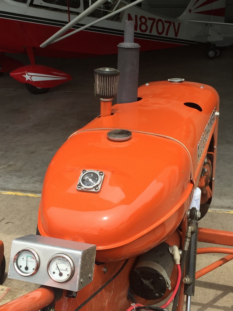

Posted By: wbecker
Date Posted: 07 May 2017 at 6:45pm
I but a d14/D15 engine in my B that I lowered for mowing with a 6' mower.
Besides what others have mentioned:
   you need to use the B radiator and fan, this is not ideal as I find on a 95 deg day mowing tall grass it runs around 200 deg or more, not a problem just info.
  Also need to add a temp gauge somewhere other than the gauge on the hood.
  The oil fill/breather cap is in a different place, need a new hole in the hood.
   The air filter will not fit with the D10/20/14/15 exhaust manifold, I fabbed up a pipe and put a K&N on it.
I also riveted on a plate to cover the B water temp & oil fill hole.
So it is very doable, but takes some work.

Posted By: PaulB
Date Posted: 08 May 2017 at 4:49pm
The D15 had the oil fill at the right front corner of the and a vent at the rear of the Valvecover. The D14 tractors had the filler/breather angle out to the right at the center. The D10 & D12 had it near the front and straight down. As far as I know there was not anything for the 138/149/160 engines that will match the hole in the hood of a B. Get a spare hood and a D10/12 valvecover will be you best bet.
Posted By: wbecker
Date Posted: 08 May 2017 at 8:46pm
This is what I did with the hood on my B with the D14 engine installation.
Posted By: CrestonM
Date Posted: 09 May 2017 at 9:22am
Neat! So, is that the new oil fill hole on the right? If so, I already have a hole there where my gasoline starter tank is.
Posted By: wbecker
Date Posted: 09 May 2017 at 9:42am
Creston, yes the hole on the right is for the oil cap. But this valve cover is from a D14, I don't think the oil cap on a D15 would be in the same place.
Bill
Posted By: wbecker
Date Posted: 09 May 2017 at 9:44am
Looks like PaulB explained the oil holes for both above.
