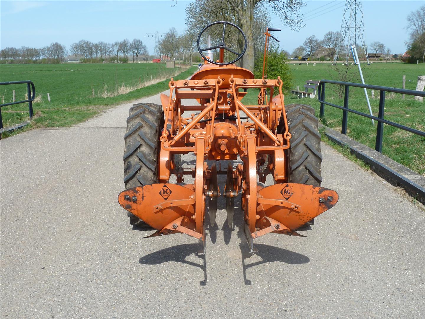

Posted By: Ken in Texas
Date Posted: 12 Sep 2016 at 9:17pm
Here is a picture of a left right 2 plow set up on a B for reference.
The ones on the B are independently operated up and down by hydraulics.
   The two hand levers on the C here indicate the plows were independently raised and lowered by hand.
Look close at the B and you can see the plow debth control lever to the right of the steering wheel

Posted By: Chalmersbob
Date Posted: 12 Sep 2016 at 11:01pm
Ken
Only the B uses that front plow adjuster lever. The c uses the levers on the rear rock shaft to adjust depth. A manual lift for the C is very similar to the manual lift on a B and mounts on the right side of the tractor. Bob
Date Posted: 12 Sep 2016 at 11:18pm
I finally figured it out CB after digging out my B/C tractor mounted plow manual.
What he has there and won't use could make somebody with a C and a plow with no mounting hardware a very happy camper.
Having never set up a plow on a C I was just guessing.
What are the 4 rods attached to the rock shaft he is taking about? One pair is up the other hangs down.
I guess the big ? is what year is it? and What happened to the plow?

Those rods on the back of your lift arms are for the C cultivators. You already have the brakets for the mounted plow, but there was also a sickle mower and a planter that one could get for the C. The white oily goo on the valve cover is from condensation. I would say you do not have any coolant in you oil, otherwise the oil on top of the cylinder head would look milky. Your overheating problem might be a too lean of a carb setting in addition to some of the other problems mentioned above. If you have any other questions, feel free to give me a call at 920-598-1287 Congratulations on your new orange tractor!

As stated, the rods attached to the rear rockshaft are part of the cultivator lifting mechanism. There are tubes the slide over the rods and go to the front cultivator gangs. The plow drawbar is the gadget mounted under the tractor. It only raises and lower a shot distance because it is the depth control for the plow. The plow itself lifts off of the rear rockshaft. Fun littler tractor you have, enjoy it. LOL Bob
