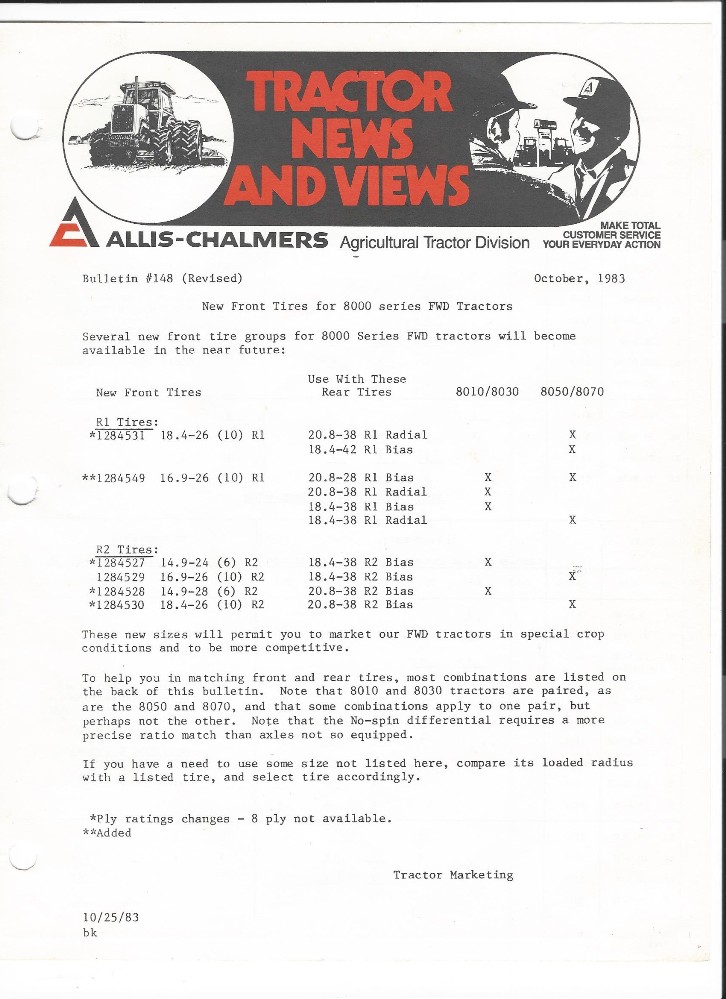

Posted By: allischalmerguy
Date Posted: 02 Jan 2016 at 8:14pm

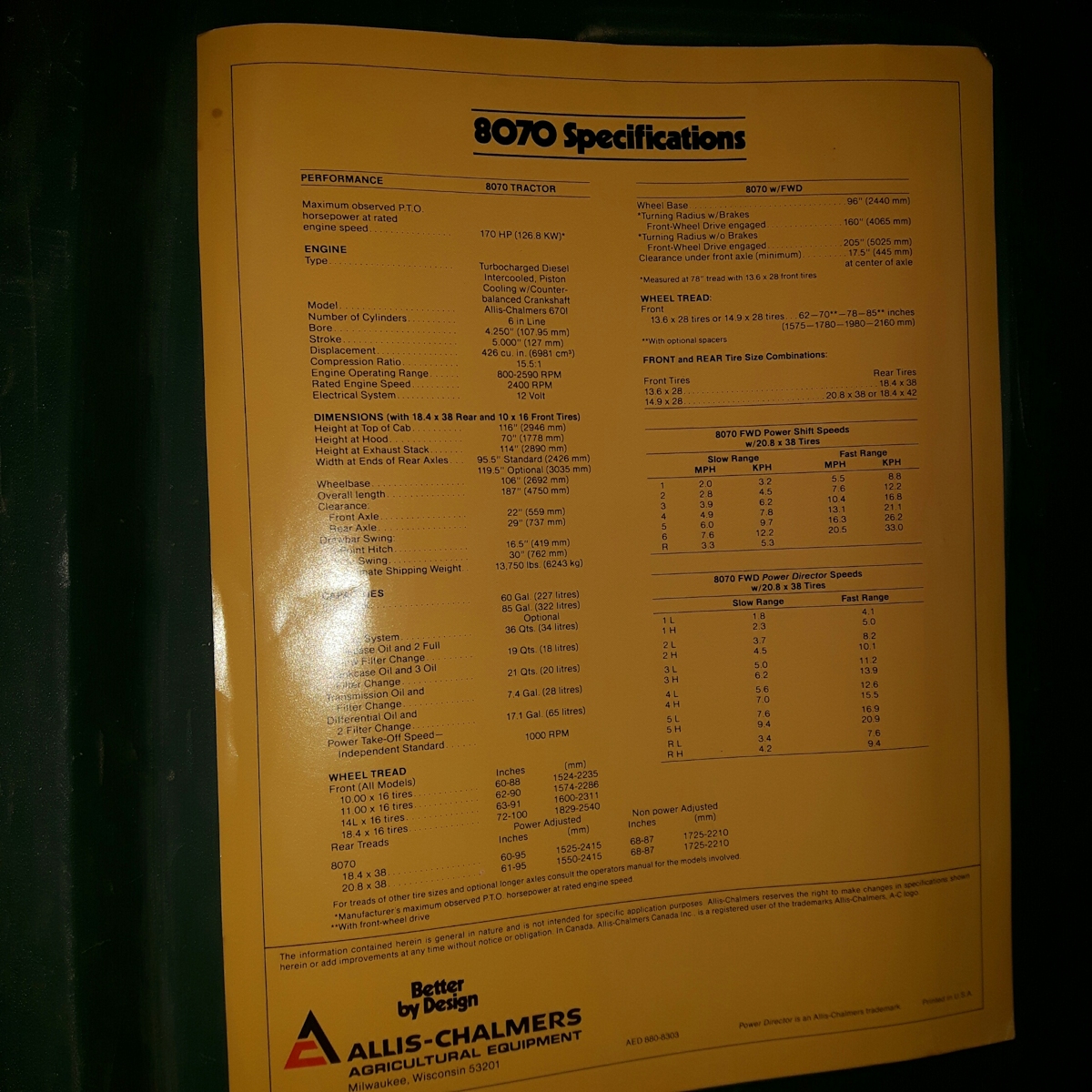

Fred Dunlop wanted to share these with you all.
Date Posted: 02 Jan 2016 at 8:15pm
Date Posted: 02 Jan 2016 at 8:17pm
Posted By: Nebraskafarms
Date Posted: 02 Jan 2016 at 8:37pm

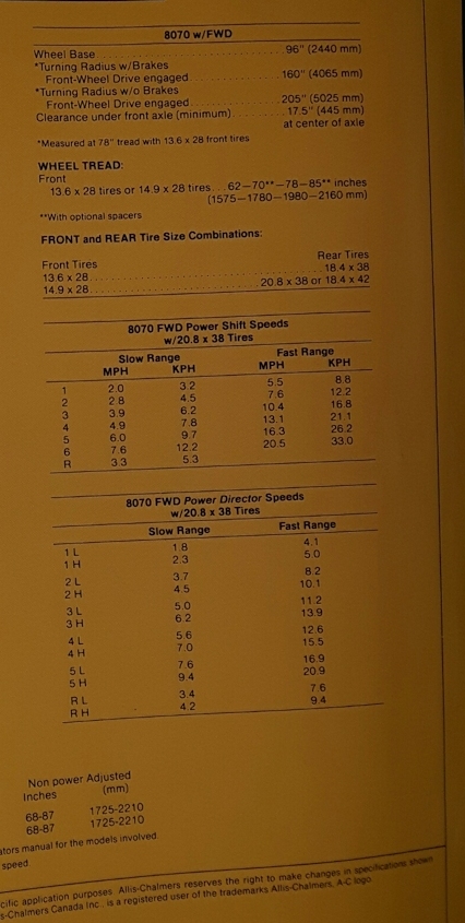

Would you please post the specification page so we can please see the right hand side of the page??  Thanks
Date Posted: 02 Jan 2016 at 8:50pm
Neb try this.
Have it in the window of your computer. Then hold down the control key and hit the - (minus) key it should make your screen smaller so you can see it.

Posted By: WD45
Date Posted: 02 Jan 2016 at 9:10pm
At bottom of page of 8070 specifications as shown above   number is AED 880-8303

So I dont think anyone answered this... was allis actually putting on these 26" rims on the tractors??  My tractor is a late 1984.  Seems like guys with 85's are who have 26's... maybe Allis was getting rid of surplus parts?

ALLIS ABSOLUTELY DID PUT 26 INCH FRONT WHEELS ON SOME OF THE LATER 8000 TRACTORS!!!! I SOLD 3 OR 4 OF THEM LIKE THAT! THE ADVERTISING LITERATURE DIDN'T ALWAYS REFLECT WHAT WAS COMING OFF THE ASSEMBLY LINE !! IT ALSO DIDN'T REFLECT THE LATEST POWER SHIFT TRACTORS HAD A FASTER LOW RANGE, BUT THEY DID !!!   Also, a 20.8 takes an 18 inch wide wheel and an 18.4 takes a 16 inch wide wheel.

Posted By: grinder220
Date Posted: 03 Jan 2016 at 12:48pm
Originally posted by Daehler Daehler wrote:
Originally posted by Unit3 Unit3 wrote:
IF; one was to put on 18.4R42 on the rear, did AC have a larger center casting or would I have to run those butt ugly step up rims?
On my 42 the piece that holds the rim to the center is longer. Its a factory non power shift rim with Mexican hat centers. Looks as a 20.8 38 but there is more of a gap between the rim and center.
can you post a picture? I've been curious about a way to go to 42 inch on my 7050. Step up rims are pricey.
Posted By: ILGLEANER
Date Posted: 03 Jan 2016 at 12:56pm
I have a set of factory 18.4 x42 s on the rear of my 8070.
Posted By: Gerald J.
Date Posted: 03 Jan 2016 at 2:23pm
The Titan Goodyear ag tire handbook recommends W16A or DD!6 for 18.4-34 bias and approves W15L. For 20.8-38 it recommends W18A, DD18 and approves DW18A.
For radial 18.4R38 it recommends W16A, and approves DD16, W15A, and W15L.
For radial 20.8R38 it recommends W18A and approves DD18, and DW18A.
A bias ply 20.8 on a 16" rim will be larger rolling diameter than on an 18" rim. Radial with its belt may not be larger but the sidewalls will be more bulged and probable not like the extra flexing for a long time.
So that book says 20.8 shouldn't be on 16 inch wide rims. Other tire makers may have a different opinion.
Gerald J.
Posted By: Unit3
Date Posted: 03 Jan 2016 at 8:24pm
ILGleaner, next time you have a camera around your 8070, snap a picture or two of your 42's please.
Posted By: Joe(IA)
Date Posted: 03 Jan 2016 at 9:16pm
Unit 3 i have 18.4x42 on my 8050 two wheel drive just a mile from you.  I bought it with butt ugly step up rims as you say, but in my opinion look pretty natural compared to some you see!
Posted By: Unit3
Date Posted: 03 Jan 2016 at 9:28pm
Well Joe, I can't do better then that. LOL. When did you get an 8050. I only see the 7000 series when I drive by.
Posted By: Joe(IA)
Date Posted: 03 Jan 2016 at 9:46pm
I told you I bought a 8050 with 3700 hours when we were waiting in line at Maxyield.  Its not at the home place.  In my shed west of you at my hog site.  Even tho my brother runs a case store you still can't get the orange out of your blood.
Posted By: Joe(IA)
Date Posted: 03 Jan 2016 at 9:47pm
Im sorry east of you
Date Posted: 03 Jan 2016 at 11:46pm
Yes I will. I will sell you the cast centers and rims and tires and throw in the tractor for free !!!!
      IG
Posted By: Unit3
Date Posted: 04 Jan 2016 at 4:34pm
Well, I would, but, ahhh, well, you see, I, ahhh, well, ----- its its its the ahhh whole money thing.
Posted By: michiganmarty
Date Posted: 04 Jan 2016 at 5:34pm
So, does anybody know what a difference the no spin axle would make with ratios. I didn't see this chart when I put the 14.9 with the 18.4x42. There wasn't a lot of difference between the 20.8x38 and the 42's, and I see a lot of 20.8's with 14.9's. I think the manufactuer has a lot to do with it also.
