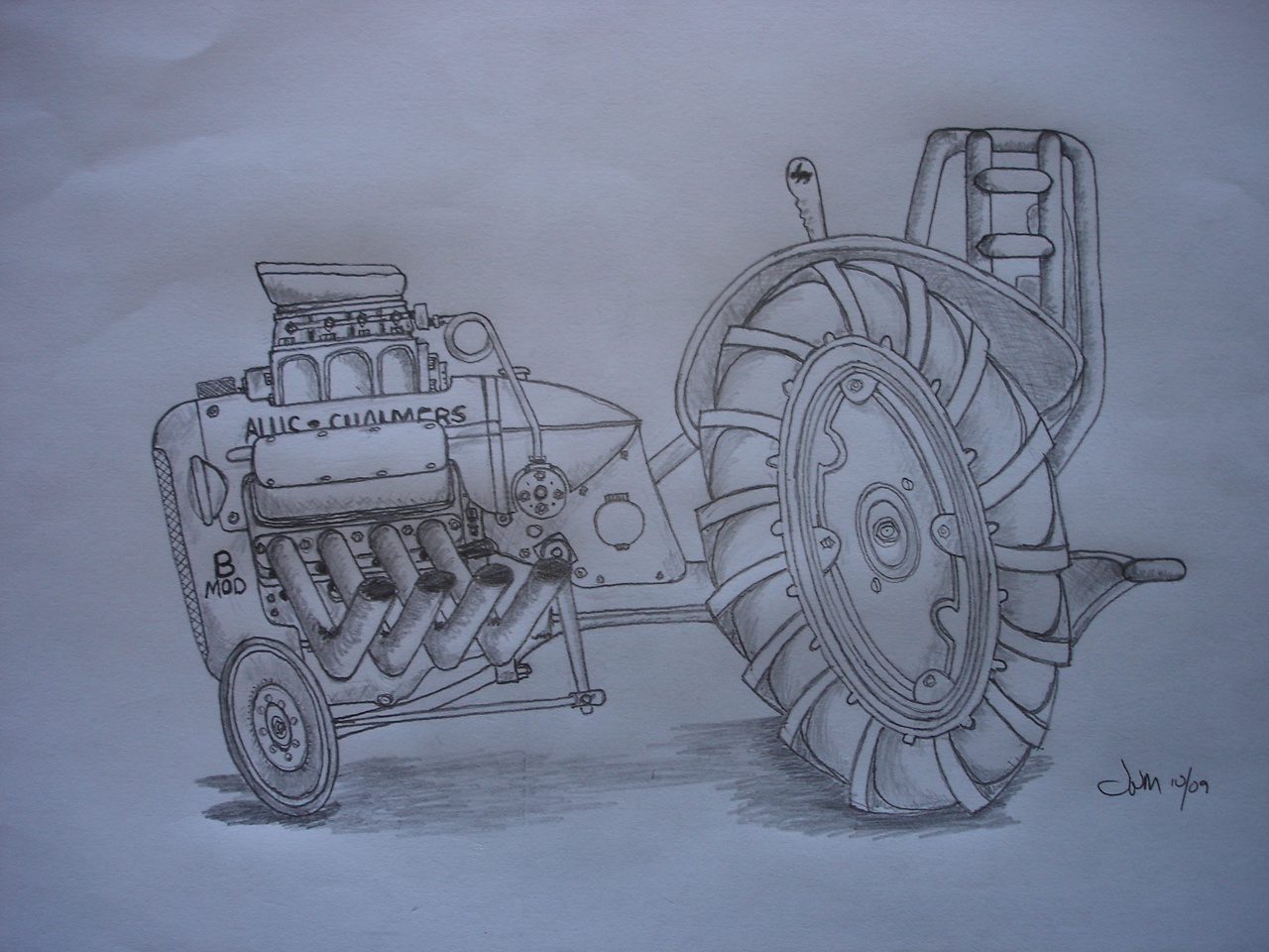

Posted By: Jeff(WD45-SATX-TN)
Date Posted: 28 Jul 2015 at 3:51pm
Close as I have gotten, only blown big block!

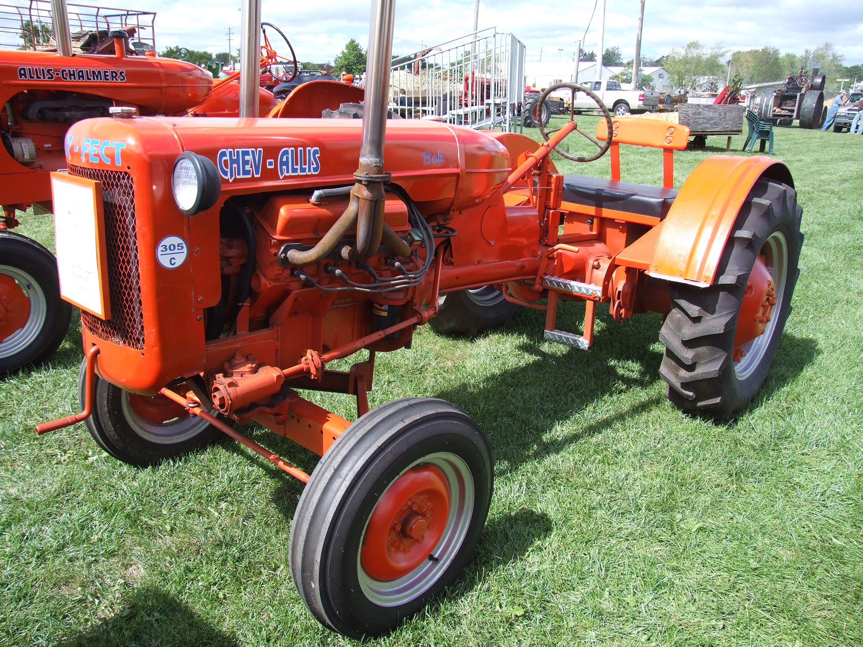

Posted By: bluewavecaptain
Date Posted: 28 Jul 2015 at 8:12pm
Anything is possible... Not my tractor. Picture taken in Union Grove, WI last year.

A v8 pic in a b W/gov setup. There is a 3/4" plate to mount engine to torque tube. A spacer between crank and stock b flywheel. The b flywheel is drilled to chevy bolt pattern. It uses the stock b clutch and pressure plate. I had to redo the radiator w/bigger inlet on top and move the lower hose fitting to the opposite side and enlarge.
