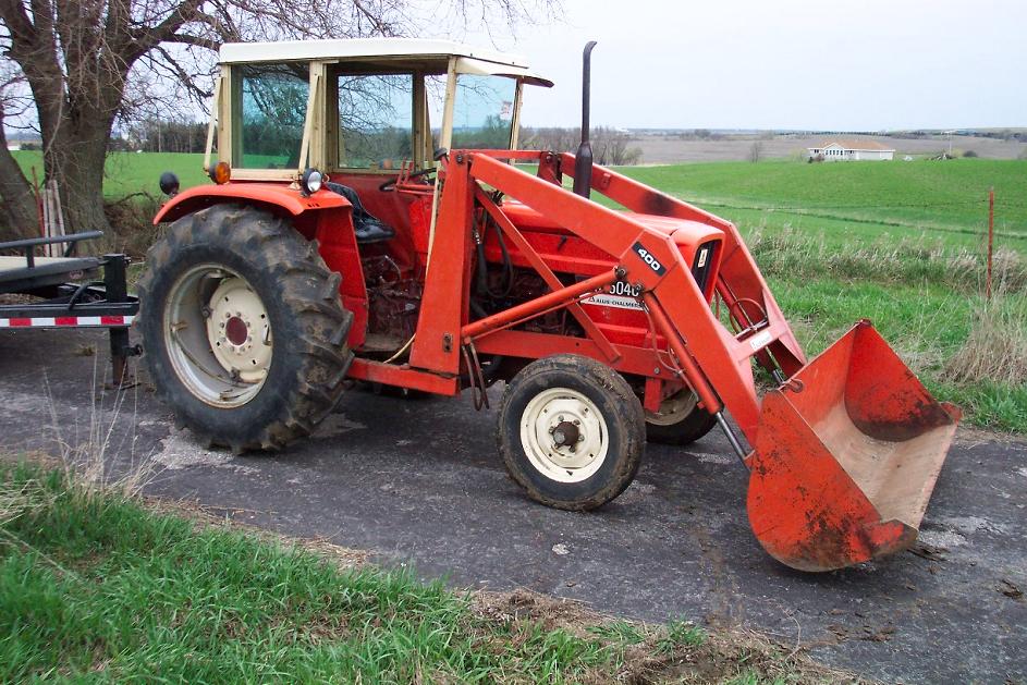

It came with an AC 400 loader.

I had one until 2 years ago when I had a stroke, open heart surgery, and then skin cancer and the boys told me I needed to sell it. It had a 400 loader on it and was in fair shape, I sold it for $4900.00. Ihad it for 8 years and the only thing I had to do to it was seal 1 lift cylinder.
